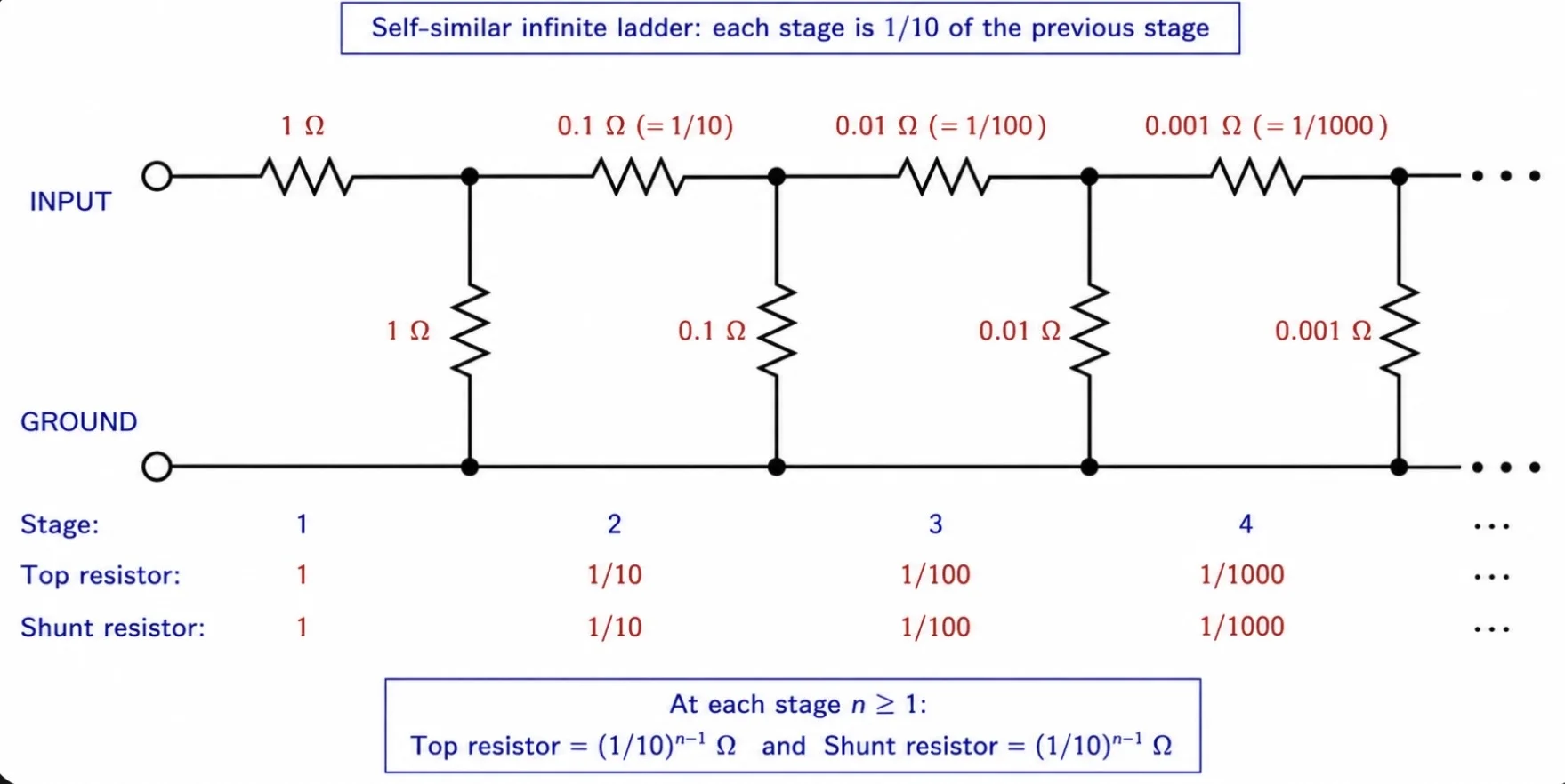

Hello everyone,
I think the exact value should be $$R_{\infty} = \sqrt{26} - 4 = 1.099019513592785,$$ that is the solution of the equation $$ x = 1+ \frac{1}{\frac{1}{1}+\frac{10}{x}},$$ or $$x^2+8x-10 = 0,$$ since the equivalent resistance at the right of the first vertical resistor is equal to that at the input divided by 10 (it is an infinite ladder ...). Do you agree?
Welcome to PF!
I believe you are solving a different ladder that goes like this:
The ladder being studied in this thread has the same top resistances but the shunts increase by ten for each stage. In your case where each stage changes both resistors by the same factor, it can be solved exactly and gives the answer you gave.

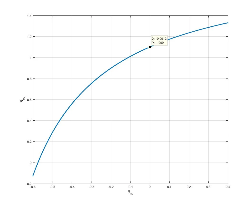

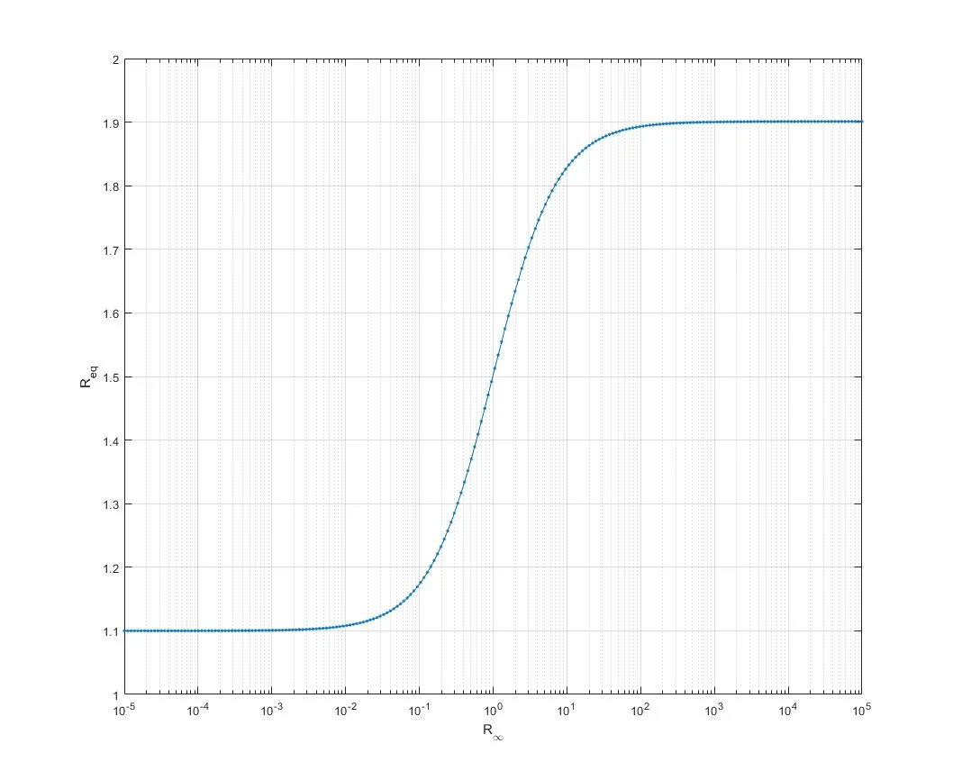

Yes, you are right, very stupid mistake on my side. When I realized it, I decided to simulate the circuit (100 stages) with a Matlab/Octave script, changing the resistance at infinity (far right), and I got this graph:
It shows that the input resistance can go from about 1.1 (short) to about 1.9 (open), as reported also by @Baluncore.
Then, just for fun, I tried to obtain my value (1.099), and I got it, with the help of a 'slightly negative' resistance (~-1.2e-3)! Look at this other graph:
where I extended the range of the resistance at infinity to negative values (here the horizontal scale is linear, not logarithmic). It is even possible to get a short (0 value) as equivalent resistance ...
I think there is something interesting here, namely the infinite ladder cannot be said to have any equivalent input resistance, UNLESS we specify also the behavior at infinity, with a resistance at the far right (kind of boundary condition). Changing that value, we get different equivalent resistances. Of course, negative values are only for fun, but any value between 0 and ##+\infty## (short/open) should be considered 'reasonable', without preferences.

Which circuit are you simulating with 100 stages? Our original ladder in post #1 or your ladder? Not sure what you mean by “changing the resistance at infinity”? It seems to me simulating a 100 stage ladder, it will make no difference what resistors you add or how you add them at the final stage.
It makes a difference for a zero ohm termination = tail.
Changing the tail, the starting value for evaluation, of a 100 term ladder.
1.900991080179288 ; Tail = 1e+201 = infinite, open
1.900991080179288 ; Tail = 0.8e+101 = good approximation
1.900991080179287 ; Tail = 1P = 1e15
1.900991080178494 ; Tail = 1T = 1e12
1.900991079385424 ; Tail = 1G = 1e9
1.900990286316557 ; Tail = 1M = 1e6
1.900198002672590 ; Tail = 1k = 1e3
1.502282916827386 ; Tail = 1 ohm
1.099990001000000 ; Tail = 1e-201 = zero, shorted
