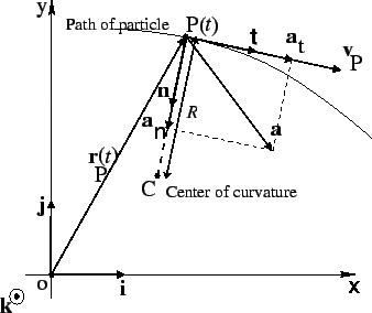

Is this the picture of the problem?( uploaded )
Well in our case, there isn't any tangential acceleration right?
I can't seem to find a way to calculate the normal acceleration using only the 10m/s couse that doesn't change...what can that tell me?

There is. It's the component of gravitational acceleration along the velocity vector. It's what makes the object accelerate as it follows the curved path. Normal acceleration curves the path.

What direction is the normal to the velocity vector at that point? What angle does that normal make with the direction of gravity?

If i find the angle between ##a_n## and ##g## its simply ##gcosx=a_n## right?

Yes, it's the gravitational force acting normal to the velocity that curves the trajectory.
Right!

So it should be 45 degrees as the velocity in the x and y are 10m/s. But what if we are taken 1 s more? How does the angle depend on the time?

You tell me. Only one of the velocity components will change.

I see, ##V_y=V_tcosx##
OK. Here's what I would do, for any time ##t##:
##V_x## is constant
##V_y = gt## (downward)
Then use a bit of trig to find the angle from the vertical.
