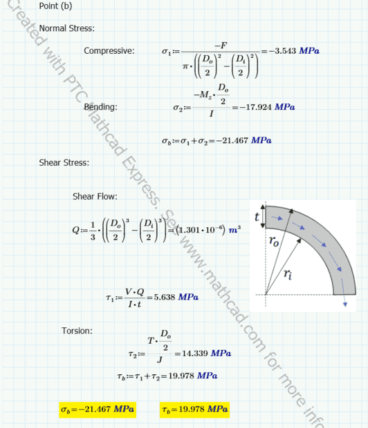

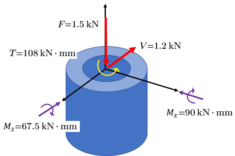

Here is my combined loading:
The book solution for normal and shear stresses respectively are:

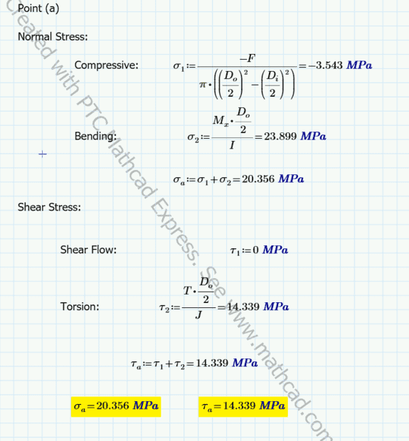

a) ##20.4~\text{MPa}, 14.34 ~\text{MPa} ## - I find both
b) ##-21.5~\text{MPa}, \boxed{19.98~\text{MPa}}## - I find the normal stress, but I'm not getting the book answer for the shear stress.
I'm getting Torsion + Shear Flow ##\approx 25.6 \text{MPa}##
I'm just brushing up for the heck of it...No professor to ask. Does anyone get solution in the book?

I may be wrong, but for the cross-section shared by points a and b, my values are:
Fx = 0
Mx = 90 kN-mm
Fy = 1.5 kN
My = 108 kN-mm
Fz = 1.2 kN
Mz = 67.5 kN-mm
Would you mind to verify?

Sorry, I had some bad editing there. Yeah, those match my values.
Never mind. I believe I found the problem. For the shear flow in a pipe (or other closed tubular geometry depending on position I suppose):
$$\tau = \frac{QV}{I (2t)} $$
Its either that or you only use a quarter of the pipe in ##Q## computation( I was using a half - with single wall thickness). To use a single pipe wall thickness ##t##, the first moment ##Q## is computed for one quarter of the pipe.Adding that to the Torsion gets me the book answer...

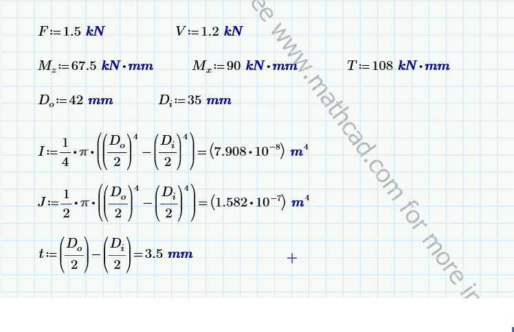

Here is my worked solution if anyone is interested.
