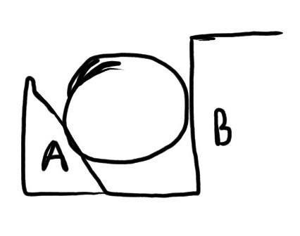

rajumahtora
Find Normal Contact force between the sphere and wedge A and wall B.
All surfaces are frictionless and in rest.
Diagram :-

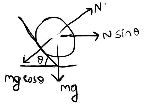

2. The attempt at a solution
Let normal force on A be N and on B be R.
My Diagram :-
By The Diagram,
N = mgcosθ ...eq(1)
R = Nsinθ ...eq(2)
= mgcosθsinθ
But the answer if :- N = (mg)/cosθ
it is not matching with eq(1).
How is this possible?
Please help me out and explain why it is wrong

N is not equal to mgcosθ. There is a component of R along N. Draw a separate FBD for the sphere showing the three forces.

But how N is not equal to mgcosθ and is R = Nsinθ correct component
R=Nsinθ is correct. As I said before, there is a component of R along N so you will have to take that into account while balancing the forces in the direction normal to wedge. Do you see now?

But how N is not equal to mgcosθ?
R also has a component parallel to N.
Resolve N into horizontal and vertical components. The sum of all forces is zero, and that is valid to the horizontal and vertical components, separately.
