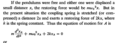

I am not sure if i get this part of a book i am using:
Why are the mwo²xa acting too? Is not 2kxa enough?
It is due to gravity.
