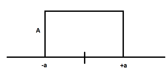

Normalise the wavefunction in the diagram which is given by:
psi(x) = A {x} < a
{x} is supposed to be mod x.
None specifically
I know that the square integral of the wavefunction needs to be set equal to 1. I am unsure exactly what I square as I haven't seen a wave-function written with a mod x. I know that mod x just means x with positive values. I know I need to square the wavefunction first so would that be:
psi(x) squared = A^2 a^2?
The answer for the square integrable of this wavefunction is A^2(2a) according to my textbook but they don't show you how. You would then have to choose A equal to 1/sqrt 2a and plug that into the original function to normalise it. I don't see how the square integral is A^2(2a) unless you take the area of the graph to be the integral of the function which is A(2a) but then if you square this then you get A^2(2a)^2?

Thanks. Could you give me some guidance on how to do this? Since the integral of any function is the area under the graph can I not say that the integral for ##\psi(x)## is A(2a)?
That's right except for that the "graph" you are talking about should be ##|\psi(x)|^2##, instead of ##\psi(x)##.

Thanks for your help. Ok so I think I get it. In my graph do we call the y-axis Ψ(x). So |ψ(x)|2 would be the square of that graph which means the amplitude A would become A^2. And the integral will be the area underneath the |ψ(x)|2 graph which would be A^2(2a), namely height multiplied by width?
Yes.

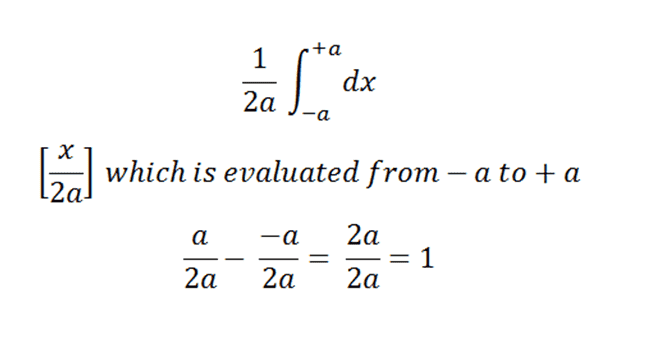

Thanks. The solution to the normalisation is A is set equal to 1/sqrt2a. This means that when you take the square integral of the original function using limits of -a to +a using this expression for A you should get 1. Is there a way of showing this mathematically by actually plugging in the limits and doing the integration as you would normally. For example if you square your new wavefunction you get 1/2a. And you can't really integrate this the usual way as you would end upw ith the integral of 1/a which is ln(a). I can see how you get it by using the area of the graph as the integral because then you get 1/2a multiplied by 2a which gives 1.
When you have a function that is defined by parts, the integral looks like
\int_{-\infty}^{\infty} f(x) dx = \int_{-\infty}^{-a} f(x) dx + \int_{-a}^{a} f(x) dx + \int_{a}^{\infty} f(x) dx
In your case, on the right hand side, the first and last integrals are 0 because ##f(x)=0## over those ranges.

Thanks. But with the middle integral are you not taking the integral of 1/2a and then evaluating from -a to +a? How do you end up with one from that integral?
I just wrote a generic function ##f(x)##. In your case, ##f(x) = \left| \psi(x) \right|^2##.

Yes it is really strange I can't quite grasp it as I find other complex integrations such as gaussian functions fine. So in this problem we are integrating 1/a with respect to what? x? So are you saying that the integral of a constant with respect to x is x times the constant?
Yes:
\int A \, dx = A \int dx = A x
DrClaude said:
Yes:
Ok, I see so I have done this to show what I think you mean for the problem in question. So is this what you mean I should get:
Correct!
