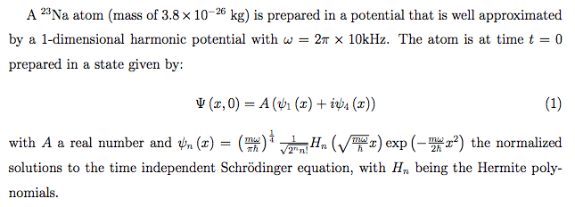

Finding the normalization constant A of a harmonic oscillator
(psi(x,t))^2=1
