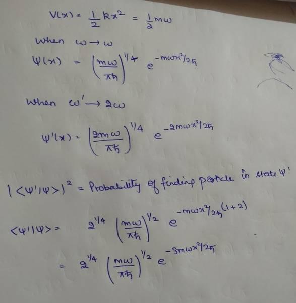

A particle of mass 'm' is initially in a ground state of 1- D Harmonic oscillator potential V(x) = (1/2) kx2 . If the spring constant of the oscillator is suddenly doubled, then the probability of finding the particle in ground state of new potential will be?

I calculated state with the wave function of one dimensional harmonic oscillator given by
Ψ = (k/πħ)¼ exp (-kx2/2ħ)
When k was doubled, new wave function becomes
Ψ'= (2k/πħ)¼ exp (-2kx2/2ħ)
I tried solving the question by calculating the probability by finding the inner product of the two but I cannot solve it

Your expression for the ground-state wave function has errors as the argument of the exponential isn't unitless.
Your approach is fine, but we can't really help you if you don't show your calculations.

I am attaching my solution in the attachment below.

To calculate an inner product, you need to evaluate an integral.
