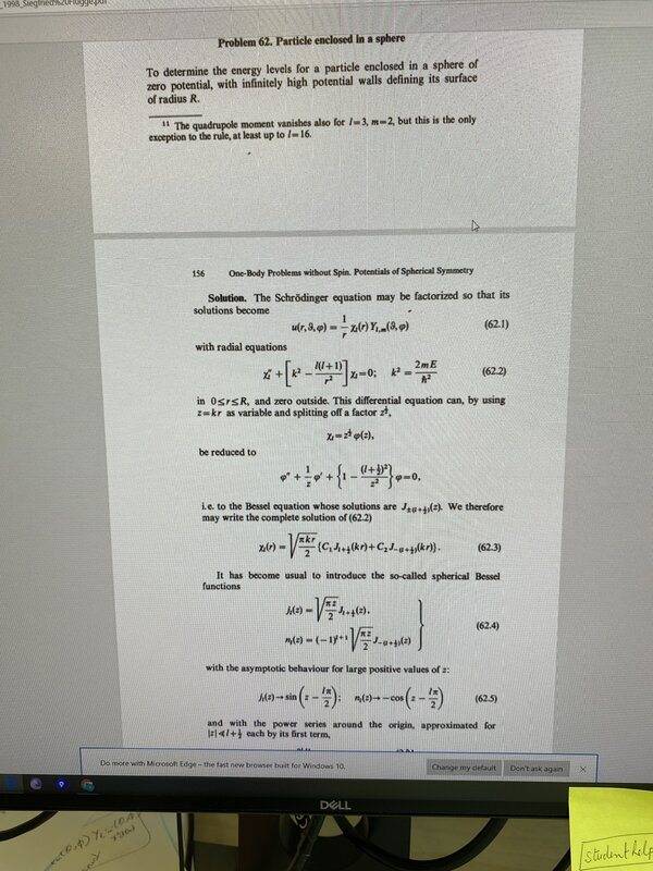

I am adding new photos .I want to solve the equation 62.7 of this problem. Its radial part diverges for zero to infinity limit. I don't know how they normalized that part. I want to do it in Mathematica

OK, so now we can read that 62.7 is in a context where ##C_2## is concluded to be zero. The argument goes on with ##C_1## for which you want to find the proper normalizing value. The author wisely avoids the normalization issue and focuses on the energy levels.
But you want to make life difficult (Bravo!) and dig in deeper. If we drill to the core, your self-assigned mission is to integrate $$\chi_l^2(r) = {\pi k r\over2} |C_1|^2 J_{l+{1\over 2}}^2 (kr) \qquad\qquad (62.3) $$from zero to any of the points where $$ J_{l+{1\over 2}} (kR) = 0 \qquad\qquad\qquad\qquad\qquad (62.10) $$ and no further as @Haborix and I have tried to point out: beyond that, the potential function is infinite and the wave function is zero.
