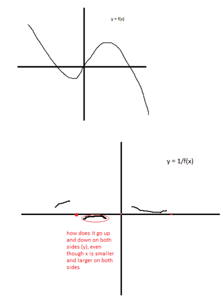

The y = f(x) is the original graph. The question asks me to draw the y = 1/f(x) of that graph. What I did was just use the same x coordinates and then take the y coordinates and just do 1/y coordinate for each y coordinate. Is this the correct way to do it?
Also, the red dots on the graph of the y = 1/f(x) are the areas of the graph that are undefined (meaning I couldn't do 1/y coordinate, because the y coordinate was 0). Does that mean that those points are asymptotes? If they are, how do I figure out if they're horizontal or vertical asymptotes?Also, you'll see that right before and after the red dots on the graph of y = 1/f(x) there is empty space. I wasn't sure if I was supposed to draw the lines of the graph up until the red dots (the asymptotes if that is what they represent), or just until the points that were available to me (the ones that I got from the original graph and then did 1/by the y coordinates).Thanks
EDIT: Those aren't my final graphs. They're just quick drawings to illustrate what I'm talking about.

Your image:
The portions you drew to this point are OK.
You should draw in the vertical asymptotes (at the red dots) and show how the graph approaches them.
What is the reciprocal of a very small positive number?
What is the reciprocal of a negative number that's very near zero?

Yes, if I understand what you're trying to say (but not saying very well). If (x, y) is a point on the original graph, the corresponding point on the graph of the reciprocal function will be (x, 1/y).
Let's call the points where you have the red dots A, B, and C, going left to right. Each of these points is an x-intercept for the graph of f. Near each of these points on the graph of f, the y values are close to zero. When you take the reciprocal of a number that's close to zero, what happens?
At the left and right ends of your graph of f, the y values are getting very large for very negative x, and getting very small (very negative) for very large x. What will the y values on the graph of 1/f be doing?

Okay, now I'm confused about something else.
You said,
But that's only because as x gets very large positvely or negatively (x→±∞), y=1/f(x) approaches zero.
I don't understand how then in my graph of 1/f(x) on that curve part of the graph that points toward the top, and is positioned to the left of the y axis, right below the x axis, as x goes towards 0, y goes away from 0, but as x goes away from, y goes towards 0, but then also goes away from 0.
I'm referring to the shape of that curve. It starts from the right or left (however you want to look at it) away from 0, and then gets closer to 0 at the middle, but then goes away from 0 again for y, whether x is larger or smaller.

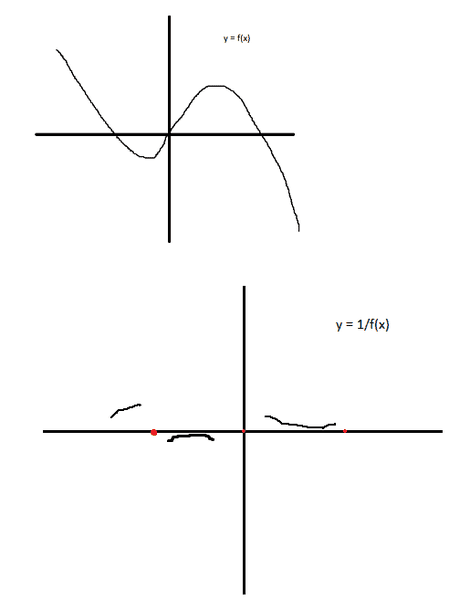

I included a modified version of the original image that might help.

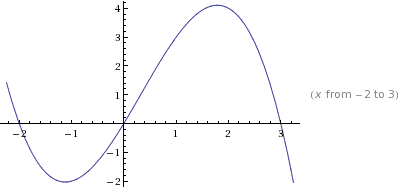

The above is a graph of y=f(x), for f(x) = -x(x+1)(x-2)/2 which looks something like your f(x).

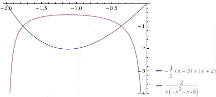

Below is a graph of y=f(x) and y=1/f(x) from x=-2 to x=0.
Thanks for the image Sammy, hopefully that'll get us all closer to the same page.
So 1/f(x) is just a representation, or what they call a reciprocal function?
It's not as if all reciprocal functions are actually 1 / f(x)? It can be 2 / f(x) like in your bottom graph?I'm still confused about the "But that's only because as x gets very large positvely or negatively (x→±∞), y=1/f(x) approaches zero." part though.
Because to me the reciprocal function in your graph approaches 0 when x becomes a larger negative value, or a smaller negative value. It also distances itself from 0 when x becomes a larger or smaller negative value.Also, for the initial graph of 1/f(x) that I included, I'm not supposed to use graphing software to draw it. So I have to do it by hand. How do I figure out how far to draw the different parts of the graph?

1/f(x) is the reciprocal of f(x).
No, 2/f(x) is not the reciprocal of f(x).
If you look carefully, you'll see that SammyS's f(x) is (1/2)(x - 3)(x)(x + 2), so the reciprocal (1/f(x)) is 2/[(x - 3)(x)(x + 2)]. The 2 here came from a denominator of 2 in f(x).

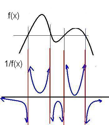

For the vertical asymptotes, you should draw a dashed line of x=c (c being some constant where the vertical asymptotes occur) and then draw your graph such that it looks obvious that as x gets closer to c, your function 1/f(x) approaches infinite. The way you do this is by drawing your graph relatively vertically next to the asymptote, and when you reach the end of your graph paper or whatever you're drawing on, add an arrow head at the end like so --->
Also, you should add arrow heads onto your graph at the end-points (the largest positive and negative values of x that you can fit), and it should be clear that y=0 is an asymptote because you should draw your graph relatively horizontally near y=0 at these end-points.
Can you figure out how many arrow heads your graph should have then?
I attach a picture with the graphs of a function f(x) and its reciprocal 1/f(x). (They are drawn by hand.) A similar 1/f(x) graph has to be drawn for the function in the OP. It shows both the horizontal asymptote (black) at y=0 and the vertical ones (red) at the zeros of the original function (I could not draw dashed lines). There are also arrows at the ends of the lines as Mentallic suggested.
ehild
