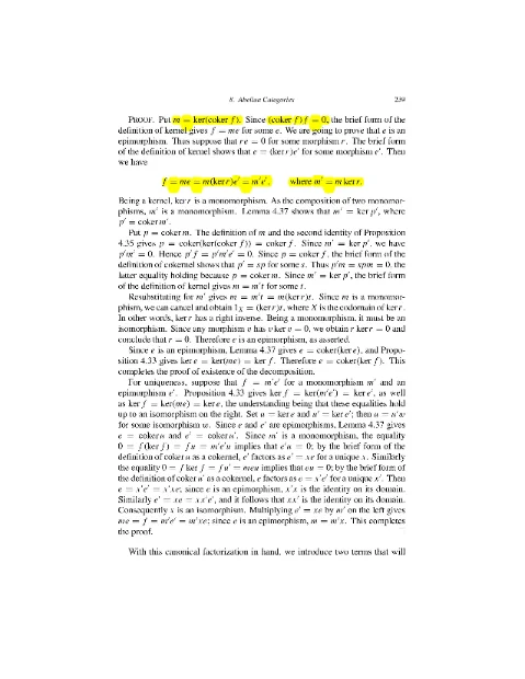

The screenshot pages below are taken from the book Advanced Algebra by: Anthony W Knapp, pp. 234-240 I also attached a pdf file of all the screenshots together.
I have notations related questions regarding the yellow hightlighted portions in each page in the below screenshots. I know they seem to be a lot, but i promise they are all related. I included page 1 and 7 for completion and for context continuity of the texts for all the seven pages.

In each of the above screenshot pages, in the hightlighted portions are the notations where my questions are derived from.
For pages 2 and pages 3:
The brief form of the definition of kernel is that ##u\circ (\text{ker } u)=0## and ##ui'=0\text{ implies }i'=(\text{ker } u) \circ \varphi\text{ uniquely }##
and
The brief form of the definition of cokernel is that ##(\text{coker } u)\circ u =0## and ##p'u=0\text{ implies }p'=\psi\circ (\text{coker } u) \text{ uniquely }##
Also on on page 3 in Proposition 4.33 it states:
##\text{ker}(mu)text[ker ]u\text{ and }\text{coker}(ue)=\text{coker }u.##
Along with the following notations in the screenshot pages:
In the next page (page 4), in Proposition 4.35 it states:
##\text{ker(coker(ker u))}=\text{ker }u.##
##\text{coker(ker(coker )}u=\text{coker }u##
and on page 5 in Proposition 4.38 where it states:
##m=\text{ker(coker f)}##
and
##e=\text{coker(ker f)}##
Also in the proof of Proposition 4.38: where in the notation, it says:
##\text{(coker f)}f=0##
and
##f=me=m\text{(ker )}e'=m'e',\text{ where }m'=m\text{ ker }r##
In the last page, we also have the
##\text{coimage f}##
If I am given a homomorphism/mapping/linear transformation ##f## in the context of groups, commutative rings or modules, where ##f## maps from ##A## to ##B##. We can define the following:
##\text{ker }f=\{x\in A\mid f(x)=0\},##
##\text{im }f=\{f(x)\in B\mid x\in A\}=f(A),##
##\text{coim }f:=A/\text{ker }f,##
##\text{coker }f:=B/\text{im }f,##
along with ##\text{im }f\cong A/\text{ker }a=\text{coim }f##
Then I would often see the two following phrases:
The image of ##f## is the kernel of the cokernel of ##f \quad(*)##,
The coimage of ##f## is the cokernel of the kernel of ##f\quad(**)##
In math notations, it would be the same as the hightlighted notation on page 5
Also for ##(*)## in math notation, it would be ##\text{im }f=\text{ker(coker f)}## and for ##(**)##, in math notation, it would be ##\text{coim }f=\text{coker(ker f)}##
It is also well know that ##\text{im }f\cong A/\text{ker }f=\text{coim }f##
My questions are as follows:
1. How do I show ##\text{im }f=\text{ker(coker }f)=\text{ker }(B/\text{im }f)=f(A), \text{coim }f=\text{coker(ker }f)=\text{coker(B}/\text{im ker }f))=A/\text{ker }f?##
2. In page 6 screenshot, the notations: ##\text{(coker }f)f=0, m\text{(ker )}e', m\text{ ker }r##;
for ##\text{(coker }f)f##, does it mean ##\text{(coker }f)\circ f##, for ##m\text{(ker }r)e',## does it mean ##m\circ \text{(ker )}r\circ e'## and for ##m\text{ ker }r,## does it mean ##m\circ \text{ ker }r##? If not, then do the notation mean operationally, like, how do I multiply ##f## and ##\text{(coker }f)##, similarly, how does one multiply ##m,##, for ##m\text{(ker }r)e',## how do I multiply together ##m, \text{(ker }r), e'##, and siimilarly for ##m\text{ ker }r?##
