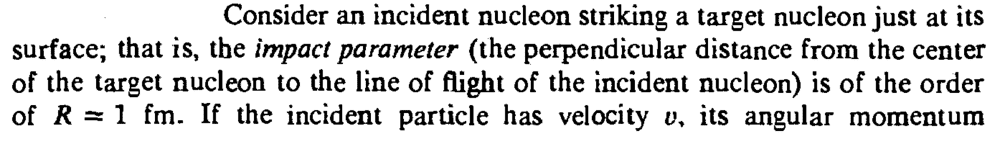

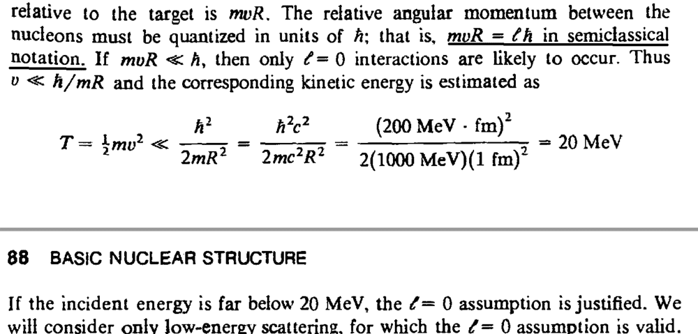

Please see image
Please see image
241525
I have found the following explanation:
Isn't ##l \hbar = mvR## (semi-classical argument) wrong? I'd state ##mvR = \sqrt{l(l+1)} \hbar## instead.
Text is coming from Introduction to Nuclear Physics; Krane, pages 87 and 88.
In the semi-classical model, you take angular momentum to be a classical vector, so its length ##\ell##.
