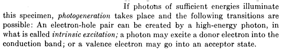

So, i can assume if 10,000 photons illuminate then 10000 electrons will be emitted. But i am mainly confused with the value of 6mA/W. I think need to convert it into eV to know the cutoff wavelength at which the electron can be excited?

From the text it says if a photon of high energy illuminates then an electron-hole pair can be created. Based on that if the 10,000 photons have sufficient energy then 10,000 electrons can be generated, that is the idea. Am i correct?

No, you can't assume this. If this were true, the answer to the original question would simply be 10,000!
Your attachment says ‘can be created’ and uses the word ‘may’, indicating the process is not 100% efficient. For 10,000 photons, *less than* 10,000 electrons will be released.
Note that the original question is basically about knocking out-electrons from the surface of a conductor. Your attachment seems to be about exciting electrons inside a semiconductor, creating electron-hole pairs. You are mixing up two different (though related) processes - which is a potential cause of confusion.
