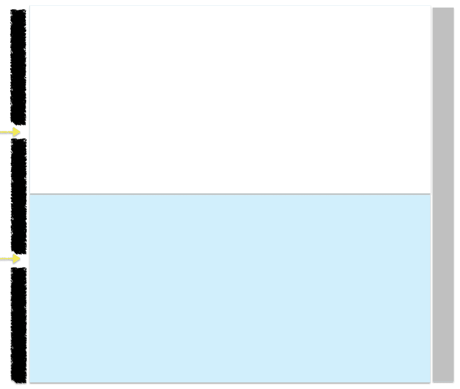

Glad you chaps have it sorted, but I still don't understand the set-up. Can we have a diagram, please?
This is the configuration I was picturing, with slit spacing ##98\lambda##, and water in the lower half/air in the upper half:
Hmm.. that's all I could think of, but then I don't understand the solution you arrived at. Below the waterline it is going to get complicated with reflections.
haruspex said:
Hmm.. that's all I could think of, but then I don't understand the solution you arrived at. One of the rays is going to be partly in each medium.
My reasoning was that for constructive interference here, the number of wavelengths in each ray must differ by an integer. And both rays will be partially in each medium. When the rays are traveling vertically, the difference in the number of wavelengths in each ray to some common point is 122.5 wavelengths. This means that no matter what, for an arbitrary point on the screen at some angle ##\theta## less than ##90^o##, the difference in the number of wavelengths in each path is going to be less than 122.5 wavelengths.
So if we slide the point on the screen upward from the central fringe, we will necessarily pass through 122 further fringes, i.e. one for where the difference in wavelengths is 1, then 2, ... and all the way up to 122.

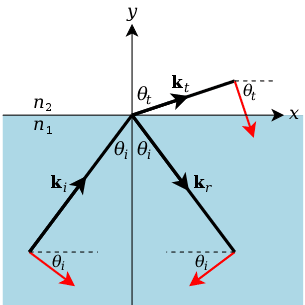

Yes, I eventually got that - very neat - and edited my post, but I am still concerned about reflections. Does your reasoning cover that?
That's interesting! I hadn't even considered that. It does make things a little bit spicy... since there might well be more/less of them.
etotheipi said:
That's interesting! I hadn't even considered that. It does make things a little bit spicy... since there might well be more of them.

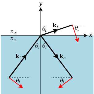

For a distance ##D\cot(\theta_c)-\frac 12d## below the water line, two rays from the lower slit will reach the screen, as well as one from the upper slit.
Of the fringes we've counted so far, the 122 formed by the ray from the lower slit traveling below the horizontal should be safe, as well as the central-not-so-central one. For the 122 above, some adjustment might need to be done. Where the ray from the lower slit has an incidence angle of less than ##\theta_c##, those fringes should be safe. However there is a possibility of extra fringes from certain partial reflections.
Where the incidence angle from the lower slit exceeds ##\theta_c##, we'd need to get rid of those fringes above the water line. I think all of these fringes are preserved below the waterline, however, so they should still be there.
Needless to say it's a much more devilish problem than I initially signed up for :wink:. It appears to be a matter of counting the number of possible successful partial reflections.
Isn't it the other way around?
Above the water line, only one ray from each slit can reach the screen. From just below the water line down a distance ##D\cot(\theta_c)-\frac 12d## there will be one from the upper slit but two from the lower. These will arrive in three different phases, mostly, so probably extra local maxima.
I was meaning to say that, initially ignoring reflections, the existing fringes formed by rays from the lower slit traveling below the horizontal will still be there. And likewise, existing fringes above the water line will still be there, except where the angle of incidence of the ray from the lower slit exceeds the critical angle these will actually end up forming fringes below the water line. But it doesn't make a difference to our counting so far, and the 245 existing ones are safe.
I think there even more extra cases with partial reflections where ##\theta < \theta_c##, where two rays from the lower slit reach the screen for distances further down from the water level than ##D\cot(\theta_c)-\frac 12d##. In addition to the extra cases you mention where ##\theta > \theta_c## which converge above that depth. `
Well, they won't be in the same places. We will have a different set of fringes, and it is not meaningful to say that some of them are the original ones.
No, they all will be there, as before.
Either my geometry is wrong or that can’t happen.
It was my understanding that you can still obtain partial reflections when the angle of incidence is less than the critical angle. This might result in rays from the lower slit being reflected to depths lower than that critical depth, in addition to those above that critical depth which you mention.
I agree with your geometry, but it holds for the cases of total reflection only. I have the feeling you are right, however, since I am unsure if the planes of polarisation differ on whether TIR or PIR occurs.
Yes, I was only counting full reflections. Partial reflections would not be very strong, would they?
