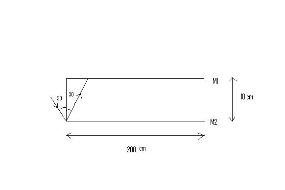

Sir,
Two plane mirrors M1 and M2 have a length of 2 meters each and are 10 cm apart. A ray of light is incident on one end of mirror M2 at an angle of 30 degrees. What is the number of reflections light undergoes before reaching the other end?
I solved it in the following way:
In each reflection the distance moved = 10 x tan(30)
= 5.77 cm
Therefore the number of reflections before it reaches
the other end = 200/5.77
= 34
But the answer given in my book is 170. Please help.

Your answer and method make sense to me; the book's answer does not.
I would also agree with you here. I obtained answer identical to yours Amith (34.64...) which rounds to 34 reflections. It seems your 'textbook' is making a significant number of errors. If you don't mind me asking what text are you reading from?
