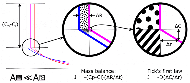

I was aware of the method you describe Chestmiller, though I wanted to see if I could make the "shell method work". However, it seemed like this method required such enormous amount of cells to calculate correct, so I went for the solution you described Chet. Thus, because I eventually were going to use my method with a numerical solution to Fick's second law:
\frac{\partial C}{\partial t} = D\left( \frac{\partial^2 C}{\partial r^2} + \frac{2}{r^{\text{*}}} \frac{\partial C}{\partial r} \right)
Where ##r^{\text{*}} = R(t) + r##, I used the following method to recalculate ##R## (In accordance with Chet's suggestion):
\Delta R = \frac{D}{(C_p-C_i)}\frac{\Delta C_1}{\Delta r_1}\Delta t
Giving a new ##R(t) = R(t-\Delta t) + \Delta R##. The reasoning by this, for those not familiar with the solution, I tried to illustrate with the following illustration:
The shell method I tried using gave correct estimates for a 1D problem, but very bad results for a 3D problem. I think I have to conclude that the shell method does work, but that it requires an extremely large amount of distinctive shells, thus leading to very high computing power requirements.
Thanks, H.
