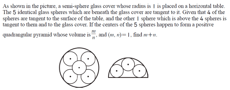

Please see below
Volume of hemisphere = ##\frac{4}{3} \pi r^3##
Volume of pyramid = 1/3 x base area x height
Let the radius of the small sphere = r
3r = 1 → r = 1/3
##x=\sqrt{4r^2-r^2}=r\sqrt{3}##
Volume of pyramid:
$$=\frac{1}{3} \times (2r\sqrt{3})^2 \times r$$
$$=\frac{4}{27}$$
So m + n = 31, but the answer is 29.
I guess my mistake is assuming line AB is tangent to the top sphere. How to do this question?
Thanks

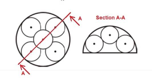

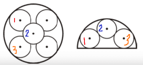

You seem to be confused about the arrangement. Look at the three spheres shown in the right hand diagram in the problem statement. Which three do they correspond to in the left hand diagram?
songoku said:
Compare how close 1 and 3 are to each other in those two diagrams. Do they really look the same?

Ah I understand and I got the answer. I am also able to prove that line AB is tangent to the top sphere but I did it by using equation of circle and straight line. Is there easier way to prove that it? Maybe using geometry or something else?

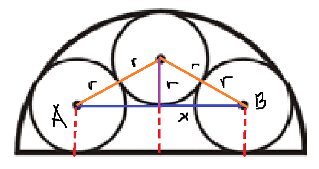

Based on your diagram and what I did in post#1, line AB is the diagonal of the base of the pyramid. Let ##a## is the length of the base of the pyramid, then:
$$(AB)^{2}=2a^2$$
$$(2x)^{2}=2a^2$$
$$12r^2=2a^2$$
$$a^2=6r^2$$
$$a^2=6\left(\frac{1}{3}\right)^{2}$$
$$a^2=\frac{2}{3}$$
Volume of pyramid:
$$=\frac{1}{3}a^2r$$
$$=\frac{1}{3} . \frac{2}{3}.\frac{1}{3}$$
$$=\frac{2}{27}$$
Since 2 and 27 are coprime, so m = 2 and n = 27 then m + n = 29

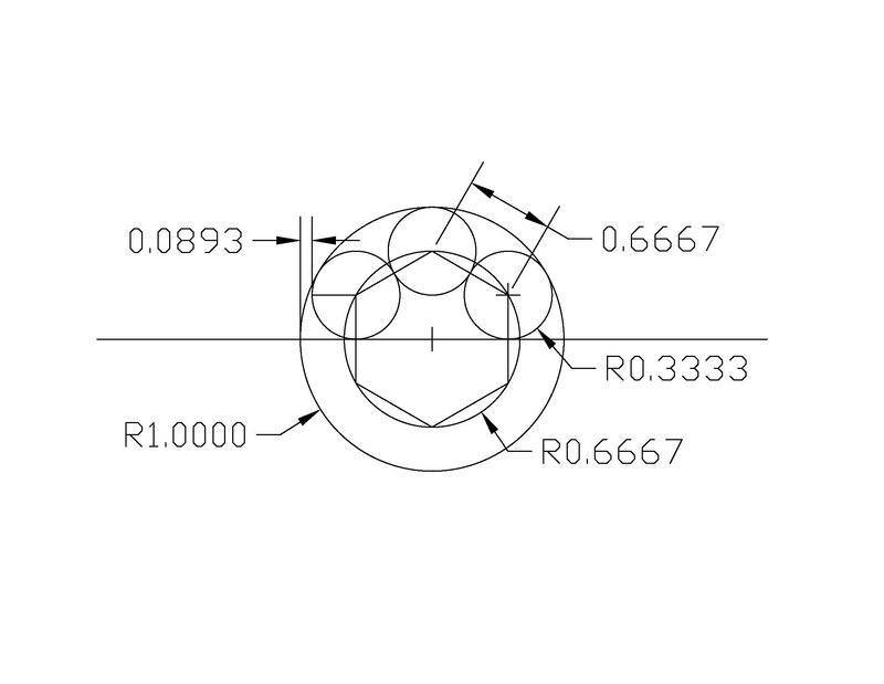

I have drawn section A-A at scale, showing the main dimensions, the hexagon mentioned by @haruspex , as well as the 0.08 gap that should be seen between the edge of the semi-sphere glass cover and the (4) smaller glass spheres when looking from above (elevation view).

Draw the hexagon as recommended by haruspex. Each of its internal angles is 120 degrees. Three consecutive vertices of that hexagon form an isosceles triangle AXB, so its other angles are 30 degrees.
Let M be the midpoint of AB. Two of the angles in MBX are 30 and 60 degrees. Since the angles in a triangle add up to 180 degrees, the other angle must be 90 degrees, i.e., the angle XMB is a 90 degree angle. XM is a radius of the top circle. The tangent to that circle at M is perpendicular to the radius XM. BM is also perpendicular to XM. Since only one line through M is perpendicular to XM, BM must be tangent to the top circle.
Note: The base of an isosceles triangle that has sides of length ## s ## and top angle ## \theta ## is equal to ## 2s\sin(\theta/2) ##, which in our problem is ## 2 \cdot 2r \cdot \sqrt{3}/2 = 2r\sqrt{3} ##, so the fact that AB is tangent to the top circle is merely tangential to the solution of the problem.
