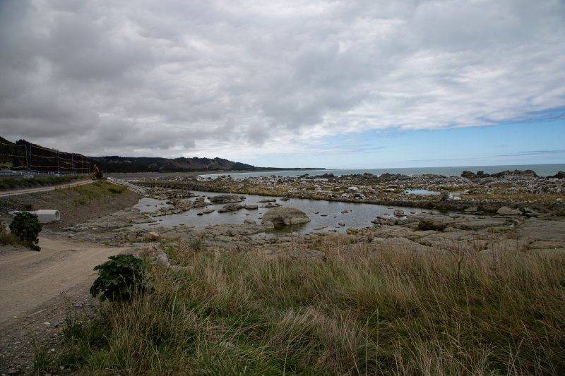

I finally got to see this for myself in March 2019 when I did a visit back to NZ. My son and I did a
road trip up to Kaikoura and then further up the coast. Road and rail damage is still being repaired
after the many landslips of the hillsides, slumping of roads and where faults crossed roads.

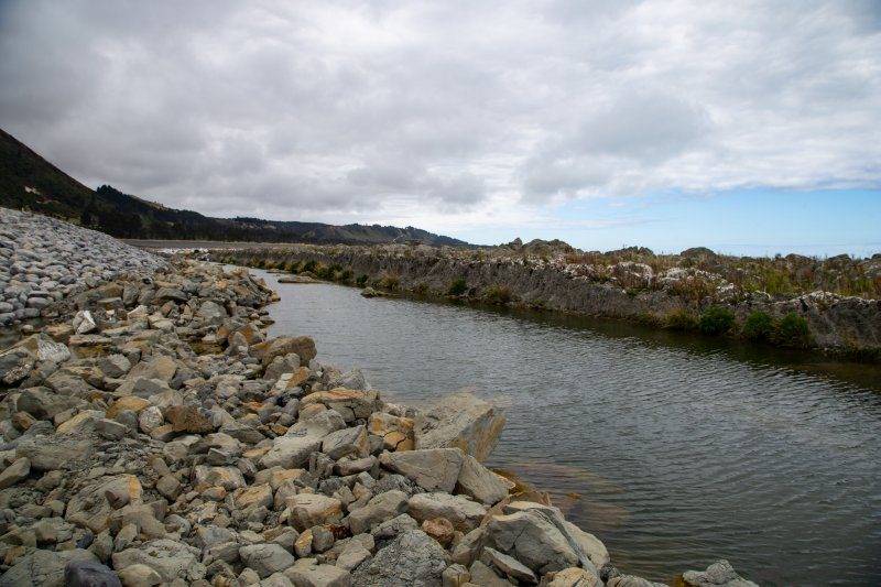

This is from the north side of the Papatea Fault, looking south. The fault runs along the base of that
that ridge where all the landslips can be seen.

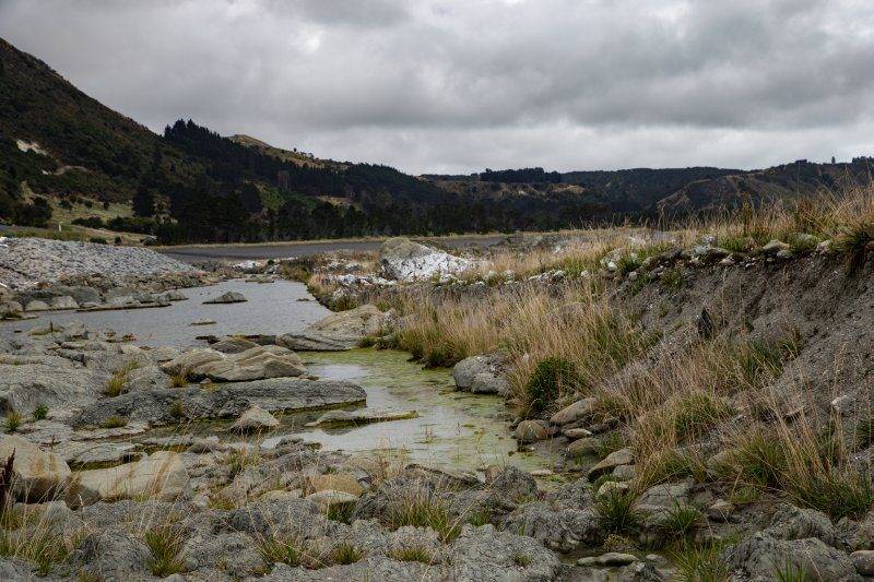

3 images of the coastal section showing the Papatea Fault
looking along strike ... total vertical offset here varies from ~ 1.5 to 2 metres
The vertical offset maxed out at around 2.5 metres. It was the horizontal offset that was
up to 19 metres
everything here that has rain water pools on it, everything on the far side of the uplifted
side of the fault, used to be under water at high tide.
My pic's show that there has been considerable weathering of the fault scarp in the 2.5 years
between when the quakes occurred and when I visited

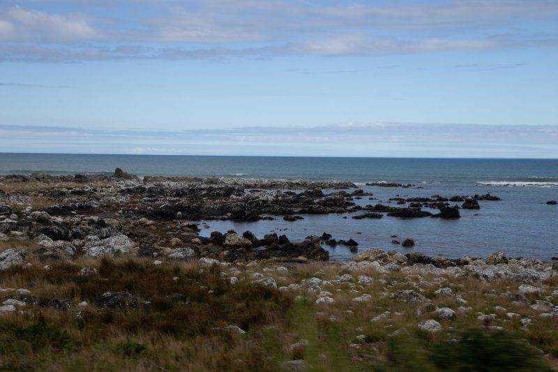

some more pic's
raised beach

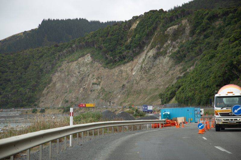

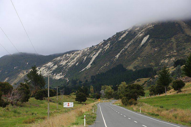

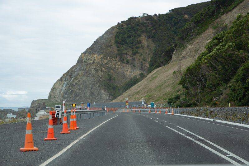

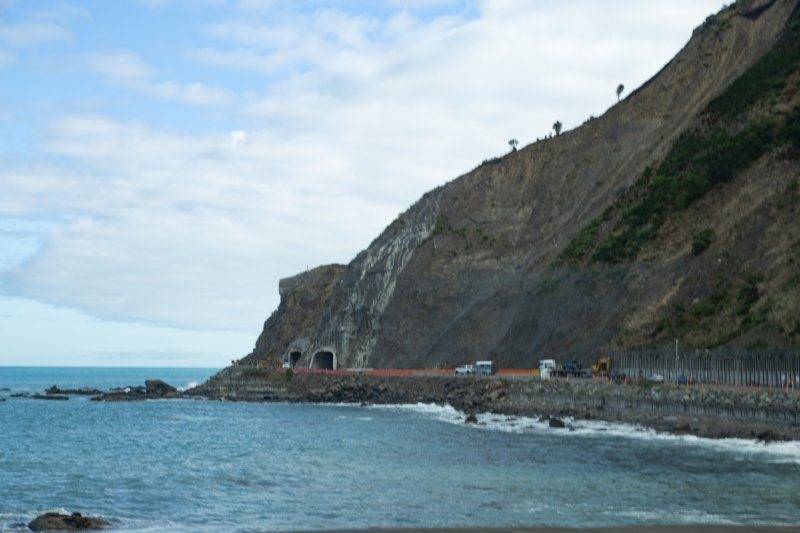

3 images showing road restoration. Most of the headlands, like in the photos, had serious landslips
associated with them
