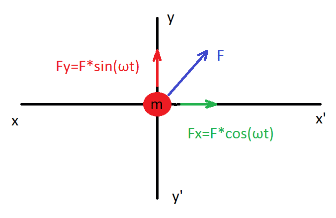

Mass object m is moving on plane x-y under the influence of constant force F. The projection Force on x'x is F*cos(ωt) and on y'y F*sin(ωt), ω=constant. For t=0 the Velocity=0. Find the V(t) and the route's length of the object until it stops for the first time.
F*cos(ωt)
F*sin(ωt)
Which could be the first step to find the V(t) ?

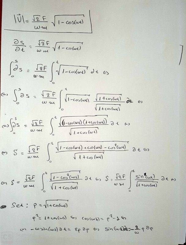

Now, for the route's length, I have to integrate one more time [ ds/dt=v ]? And try to find the s. Is that process correct ?
Yeah, you have the formula ##\mathrm{ds}=|\mathbf{v}|\mathrm{dt}##.

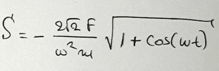

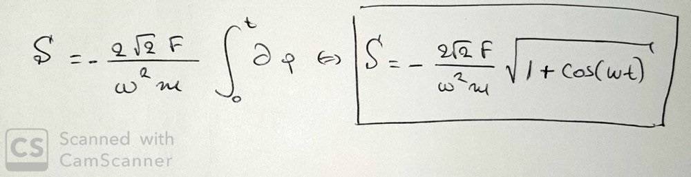

I try this, but the solution is negative, how this is explained ? And how will I work for "...until it stops for the first time "
Try just integrating the velocity to get the position as a function of time. From this, the shape of the object's trajectory should be obvious, and it will allow you to easily calculated the distance traveled.

you know what's weird? at ##t=0s## your object has moved a negative distance.

As @archaic points out in post #10, your expression for S does not give the right value at t=0. This is because you did not apply the bounds correctly. When you fix that you will find the constant of integration will ensure your result is positive, at least initially. But you may notice it still goes down after a while, which is also infeasible.
The next problem is that having taken the modulus of velocity to get speed, you must be careful what happens to your integral when the integrand reaches zero. Blindly integrating through that point might result in your inadvertently using negative values for speed. This is probably why the question specifies "until it comes to rest for the first time".
The whole thing becomes simpler if you get rid of the surd, which you can do by considering the half angle ##(\cos(\frac 12\omega t))##.

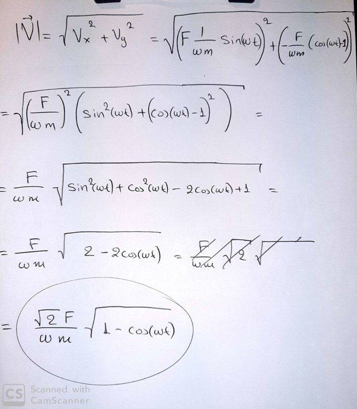

This is what you've done so far :
$$|\vec v|=\sqrt{v_x^2+v_y^2}=\frac{F\sqrt{2}}{\omega m}\sqrt{1-\cos{\omega t}}=\frac{2F}{\omega m}\sin{\frac{\omega}{2}t}$$
My calculation for ##S(t)## gives this, following haruspex's advice. You can see that it is zero in the beginning.
$$S(t)=\int_0^{t}|\vec v(t')|dt'=\frac{4F}{\omega^2m}(1-\cos{\frac{\omega}{2}t})$$
You probably have a stray minus sign somewhere.
##\frac{2F}{\omega m}|\sin(\frac{\omega}{2}t)|##
