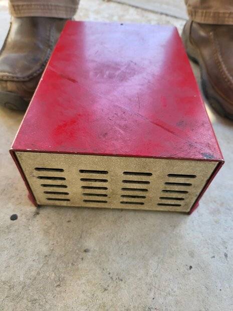

First off, not an engineer, just invading your forum as no one seems to be able to answer this problem.
I have an ambulance/fire marshals vehicle, a 1992 Ford E350 with 7.3 IDI diesel. Pre Powerstroke. It came with a red box in one of the compartments that has no labels or identification. It is heavy. It has 3 lugs for wires coming from the 160 amp alternator that state AC taps. It has 2 15 amp glass fuses. It has 2 standard 120 vac plugs that are separate, not a duplex, and they are labeled 120 volts DC. Is there an explanation for what it is and maybe what it is for? Who needs 120 vdc in a vehicle?

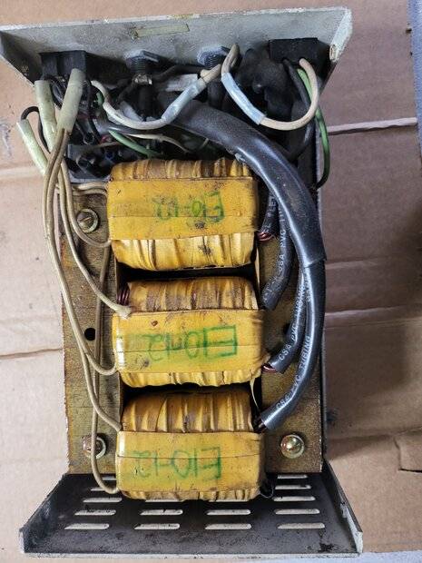

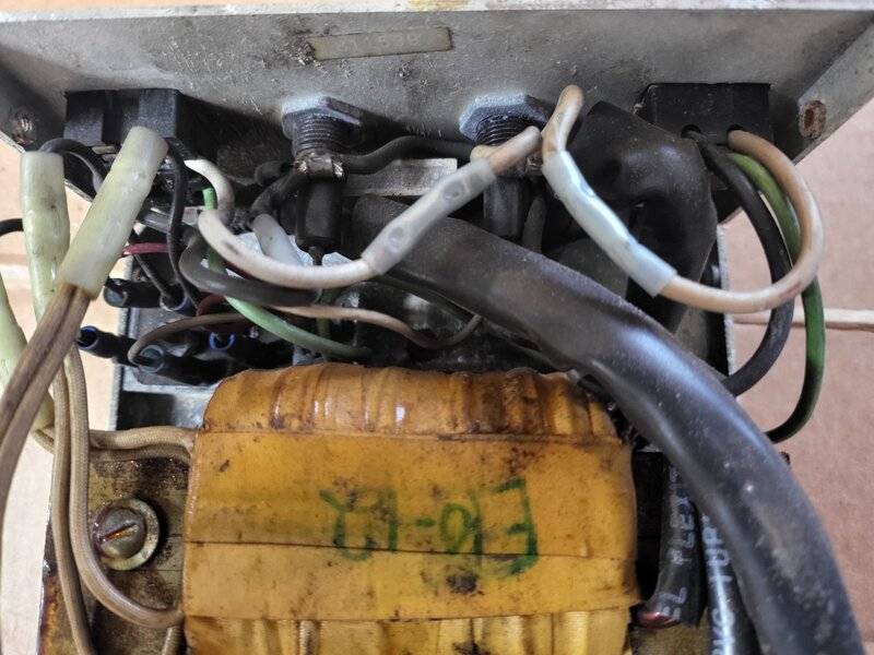

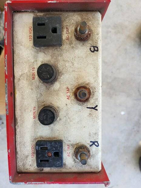

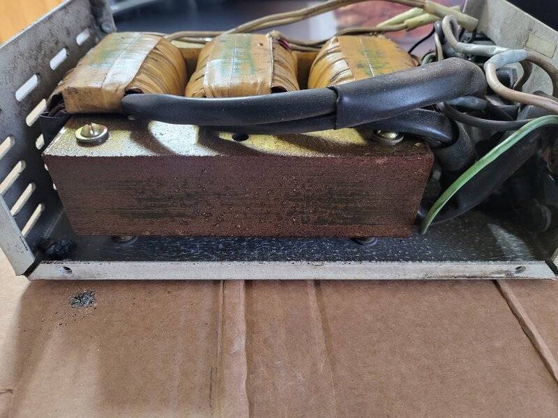

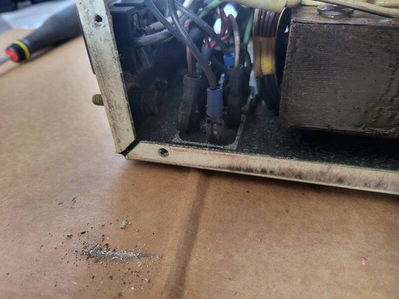

Thanks again for the responses. Here are the opened up pics. This sucker is heavy. Now I know why.

The glass fuses are not one each for the outlets. The white wire and black wire on each outlet is fused separately but connected together. This is not a homemade project. Even the lettering on the face is neat and commercial looking. Now I need to find out what equipment used 120vdc. By the way, I tested it and it is indeed putting out 120 DC.
It looks like a three-phase transformer, with bridge rectifiers to produce the DC. There appear to be no filter capacitors, so there will be some alternator ripple on the DC.
The 3PH from the alternator will have a higher frequency than normal mains power. So the transformer should have thinner than normal laminations, as used for the 400 Hz power on aircraft.
