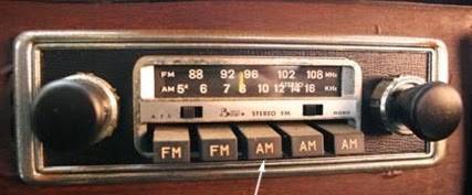

Back when dinosaurs roamed the Earth, every car had a push-button radio like this:
You pushed a button and the dial would zoom to the preset location.
To set a location, you would manually dial to the right location, then pull the button out, then push it in.
I had set my sights on figuring this out from first principles - perhaps examining on old radio from the local electronics surplus store but never got around to it.
My pride to figure this out on my own has waned, and now I just want to know what I was missing.
How does the mechanism work?

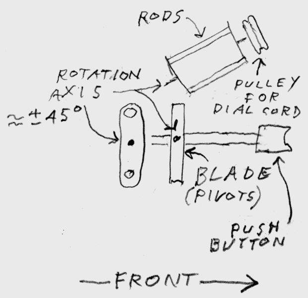

When manual tuning is done, the dialcord rotates the funny cage assembly consisting of two rods between end plates.
Pulling the pushbutton out releases a brake on the blade allowing the blade to pivot.
When the pushbutton is pushed, the blade rotates to match the two bars on the cage assembly.
Further force on the pushbutton engages the brake on the blade, not allowing further rotation.
To tune to another preset station, the appropriate pushbutton is operated, forcing its blade against the rotatable cage assembly, pulling the dialcord to the preset position.
MAGIC! You now are now tuned to the new station.

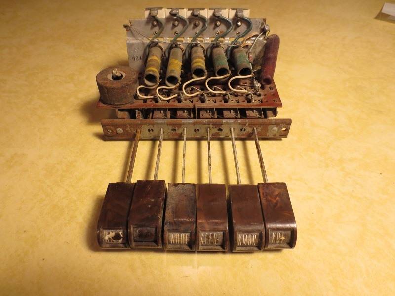

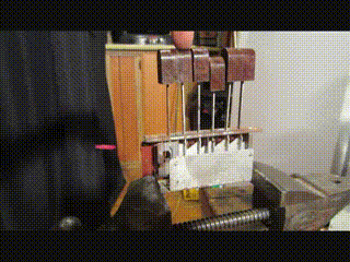

I've seen the string type that rotates a variable capacitor for changing the frequency of a tuning oscillator. I looked around for an old car radio but could only find this set of push-buttons from, IRC, an old table-top radio. With this type, each button switches in different LC tuning circuits. The switches circuit board is made of a Phenolic Paper material which is a type of Bakelite. Note that the buttons have windows where labels of the station's call-sign can be inserted.
The mechanical mechanism is rather complicated but still works, sort of:
I know I have an old push-button car radio somewhere. I'll keep looking.
Cheers,
Tom
Thanks. I'm mostly there.
I'm having trouble divining orientation from your beautiful diagram. It's hard to tell the difference between discrete parts and different views of the same part.

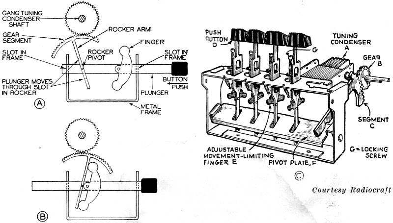

A system similar to the one described by @Tom.G :
The diagrams at A and B show one of the finger and rocker units used in the mechanical automatic tuning systems of some Crosley receivers (including the Crosley Safety-Tune auto radio), while the sketch at C shows the complete tuning unit with a gear drive to a gang tuning condenser. Tightening the screw on the plunger locks the finger rigidly in position. To set up a button for a station, this screw is loosened so the finger can rotate, the button is pushed all the way in, the station is tuned in manually, and the screw is tightened to lock the finger at the correct angle. A spring returns the button to its normal position when pressure is released, leaving the tuning condenser at the correct setting for the desired station.
Other systems descriptions can be found from the source of this quote.

The diagonally oriented part to the upper right is the front view of the 'funny cage assembly' (in the real world it is horizontal ). The rest is a view from the left side of the radio.
The left-most piece in the dwg. is the left end of 'funny cage'.
Clarification duly added to post #6.
Ohhh. Now I see it.
And now I see it in Tom G's diagram.
The only thing I can't quite make out is the brake release. I think the brake is (G), and it presses on the finger, holding its setting. When you pull the button out, it releases the brake, so that the finger can rotate freely. Then you push it in, the finger is set by the pivot plate (F) and the brake is reapplied.
