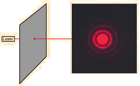

The mechanism by which light diffracts through a two-slit experiment is alledgedly due to the superposition of a single photon at the two-slit interface, causing the photon to either constructively or destructively interfere with itself.
If this is the case, then can you please explain the following phonomena?:
This is called aperture diffraction; and as you can see, there are no two slits or two apertures that the photons are interfering with, yet the diffraction pattern remains!
Please explain. Please.
There are not just two apertures that the photon passes through, but many many apertures. These "apertures" are all the points lying within the round opening, and the "waves" produced by all these possible source points interfere to give the pattern shown in your picture.
That's a pretty basic optical phenomenon there; this isn't a QM question.

Since the current idea is that the photon superposes itself through both slits (or at the edge of the aperture versus the center of the aperture as jtbell's .pdf illustrated (thx, jtbell)); and since superposition of particle/waves is strictly a quantum and non-classical in nature, this thread is very much "QM."
That's not what's going on. This is just an ordinary classical diffraction, and those airy disc calculations are done from classical theory (and were first done by Lord Rayleigh well before quantum theory) This is taught in every introductory course in classical physics (e.g. Young and Freedman "University physics", chapter 38 - Diffraction). There's no quantum mechanics in the lecture notes jtbell linked to.
No, diffraction patterns are classical "wave-like" behavior. The point of the double-slit experiment is that this diffraction pattern will arise even if you're dealing with individual quanta of light being emitted. Hence the 'wave-particle duality'.
Your light source, a laser beam, is not so low in intensity that you're recording individual photons, so it's not analagous to the double-slit experiment. It behaves like a classical light wave. But regardless, the quantum mechanical diffraction pattern corresponds to the classical one anyway.
Quantum mechanics isn't needed to explain basic diffraction patterns. If you think it is, then you need to go back and learn classical physics. I've seen single-slit diffraction explained in high-school textbooks, even.

Why do you think it doesn't? :confused:
The angular distance of the first minimum from the center of the diffraction pattern for a circular aperture is given (in the Frauhnofer approximation) by
\sin \theta = 1.22 \frac {\lambda} {d}
where d is the diameter of the aperture. Setting \theta = \pi / 2 gives you d = 1.22 \lambda. With this diameter aperture, the central peak of the diffraction pattern completely fills the hemisphere beyond the aperture.
