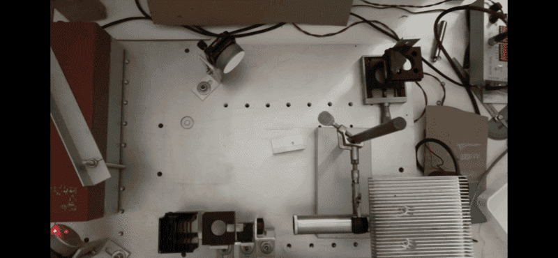

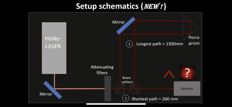

You may find this experiment interesting… he uses a single photon setup and makes the two possible paths unequal length such that the time of flight of one of the paths should guarantee a single photon can’t interfere with itself… & yet a single-photon interference pattern is still observed…

Is there a published paper on this experiment? A video is not a valid source by itself.
No paper, Its just a video showing the experiment— he sets up an optical table and uses neutral density filters on a laser to get the beam power down to single photon levels. Then beam splitters separate the beam and recombine it before entering a camera. One of the beam lengths is significantly longer than the other. He then shows when either beam path is covered the interference pattern disappears, but when both paths are open the interference pattern is plainly visible. How would you explain his results?
Assuming that there have been properly documented experiments done that show similar results, the explanation is simple: the single photon that makes a dot on the detector does not have a definite time of emission. Heuristically, it is in a superposition of having been emitted at two different times.
The way to test this would be to only have the source on for a time shorter than the difference in travel times between the two paths. Doing this should eliminate the interference pattern at the detector.

I have been interested in (and surprised by) this experiment as well, ever since I saw the video. Does it make a difference for the outcome that it is a laser that is being used? That is, what does the QM theory state that should happen when an incoherent light source is used instead?
Yes. You need the state to be coherent in order for interference and diffraction effects to be observable. An incoherent mixture of many wavelengths would give you an incoherent mixture of interference and diffraction patterns with many different spacings between the peaks--which ends up just being a blob that tells you nothing useful.
It's not impossible to get a reasonably coherent source without using a laser--for example, you could use a sodium arc lamp--but nowadays lasers are much easier to work with and control.
