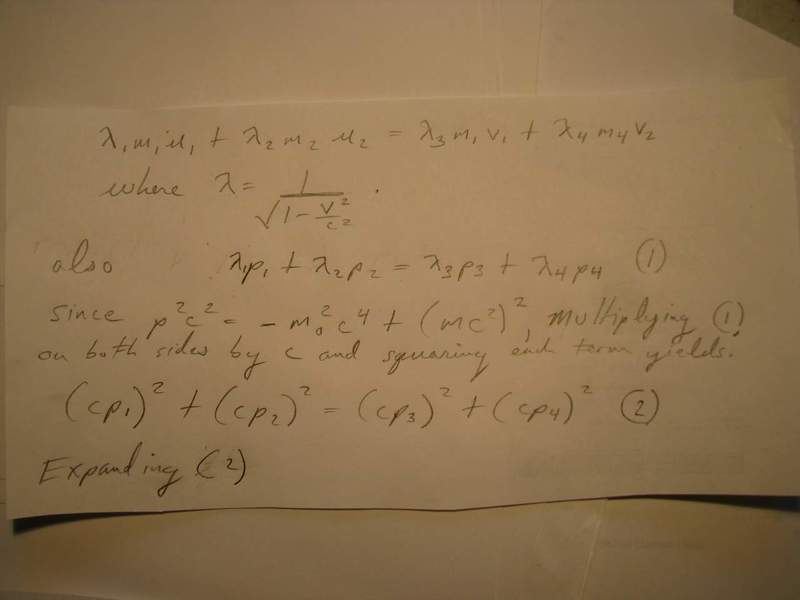

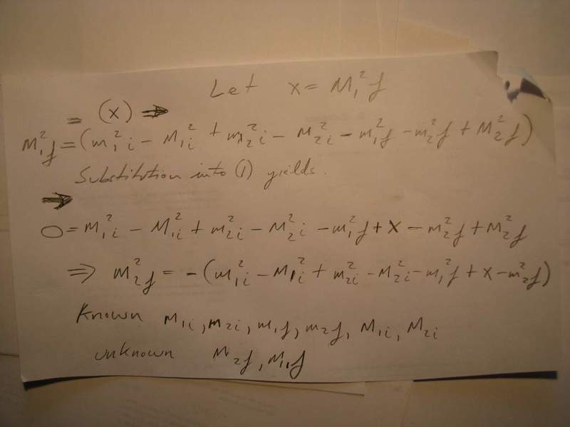

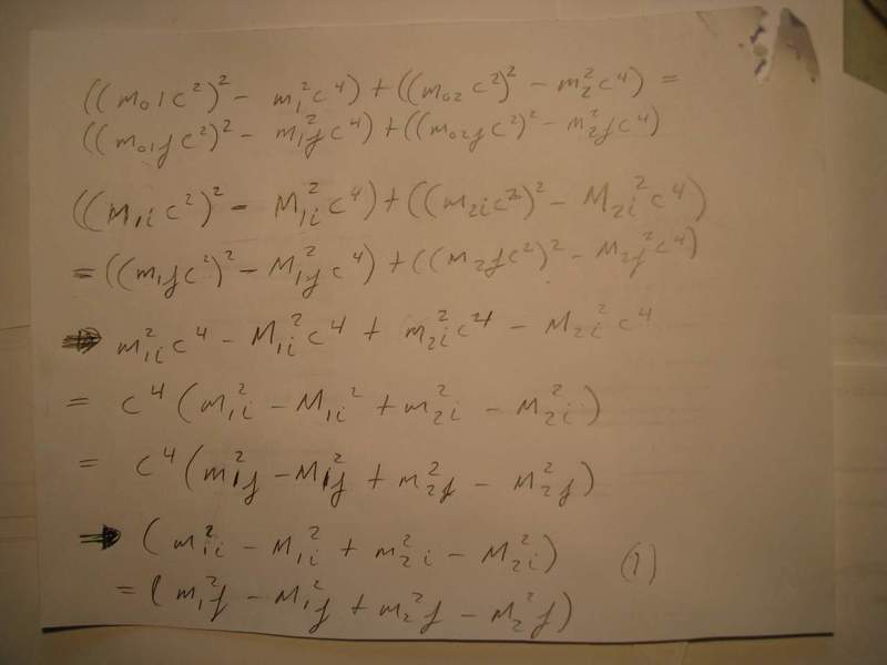

Imagine two particles of uneven masses colliding at relativistic velocities. What is the final velocity of each particle after the collision (no they do not stick together).
This question pertains to the relativistic treatment of a one dimensional collision. Basically I tried to derive the equations of motion for the relativistic case but I'm stuck. I attached what I've done so far.
I thought that solving for the Newtonian conservation of momentum case would be easy simply by putting in the gammas and solving for a simultaneous equation except that I end up with a simultaneous equation for two unknown masses (these are the relativistic masses) while the final rest masses are known. In the attached picture the unknowns are the final relativistic masses while the initial rest masses and the initial relativistic masses are known (please see the last picture at the last line).
Thanks.
  • Handwritten derivation: lambda_1 m_1 u_1 + lambda_2 m_2 u_2 = lambda_3 m_1 v_1 + lambda_4 m_4 v_2, where lambda = 1/sqrt(1 - v^2/c^2); also lambda_1 p_1 + lambda_2 p_2 = lambda_3 p_3 + lambda_4 p_4 (1); squaring (c p_1)^2 + (c p_2)^2 = (c p_3)^2 + (c p_4)^2 (2); 'Expanding (2)' written below.

  • Handwritten derivation on paper of relativistic energy and momentum conservation equations for a one-dimensional two-particle collision, with terms like m c^2 squared minus m^2 c^4, ending in a line relating the initial and final relativistic masses.
  • Handwritten derivation on paper: Let x = m1^2 f, with substitution into equation (1) yielding m2^2 f = -(m1^2 i - M1i^2 + m2^2 i - M2i^2 - m1^2 f + x - m2^2 f), followed by a list of known and unknown quantities.

See https://www.physicsforums.com/blog.php?b=1857 , the attachment entitled "Collision"
I'm looking at the final equation (3.8) where:
γ (U '1 )m1 + γ (U '2 )m2 = γ (u '1 )m1 + γ (u '2 )m2 (3.8)
which I understand to be the velocity in the "other frame" but the equation just spits back the original problem. How do I find (u '1 ) and (u '2 )?
I think these proofs only show that the conservation of momentum is frame invariant but nothing else.

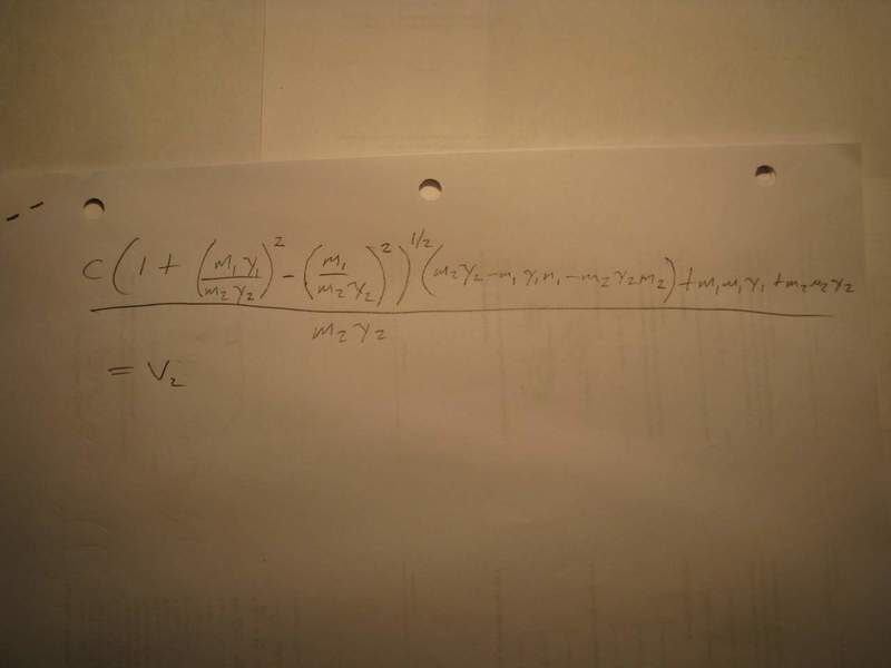

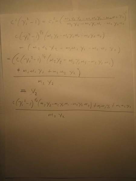

Oh, ok. So I retried doing that substitution for A and B and I attached two photos of the work. Let me know if the final result makes sense for v2 which is the final velocity. Do you know if there is a way to find v1 similar to Newtonian mechanics where:
[tex]v2f - v1f = v1i - v2i[/tex]
These are the photos, I'm not good with tex either.
https://www.physicsforums.com/attachment.php?attachmentid=26983&stc=1&d=1279283932
https://www.physicsforums.com/attachment.php?attachmentid=26984&stc=1&d=1279283932
No, it doesn't look right.

I tried to do this:
Take A and B and substitute into:
[PLAIN]https://www.physicsforums.com/latex_images/28/2801452-8.png
and then I substituted that back into B and solved for v2. The solution was long and I had trouble with tex.
Handwritten derivation on lined paper: c times (1 + (m1 γ1 / (m2 γ2))^2 - (m1 / (m2 γ2))^2) raised to 1/2, times (m2 γ2 - m1 γ1 m1 - m2 γ2 m2) plus m1 m1 γ1 plus m2 m2 γ2, all over m2 γ2, equals v2.
Let me know what your final solution looks like because at least then I could try to find that.
Thanks.
  • Handwritten derivation on lined paper: c times the square root of (1 + (m1 γ1 / (m2 γ2))^2 - (m1 / (m2 γ2))^2) times (m2 γ2 - m1 γ1 m1 - m2 γ2 m2 + m1 m1 γ1 + m2 m2 γ2) over m2 γ2, equals v2.

no, it isn't right, you forgot that [tex]\gamma_2[/tex] is a function of [tex]v_2[/tex]

You should get an equation degree 8 in [tex]v_2[/tex]. This equation does not have symbolic solutions. Nevertheless, it is a good exercise for you to finish the calculations, never give up once you start something. There is satisfaction in forming the equation. How else would you solve it numerically if you don't have the final equation?
