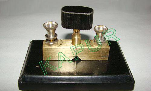

What is one way plug key?I know direct question should not be asked instead we should show some efforts,but seriously i googled it but didn't find anything.In my textbook there is no definition or anything about it ,that's why my teacher also doesn't explain it.But i really want to know.Please forgive me for not showing any effort ,but trust me i have really searched it then only came here.Here is the image of it.

I had to google with quotes: "plug key" "one way"
I'm not sure I've ever seen such devices, but it appears to simply be a switch.
Plug keys of the "one way" thru "four way" styles: http://www.tdmodelsindia.com/php/physics/physics27.php
I also can't find a description of how they work, but looking at the devices, and the schematic symbol -( O )- , I think I know how they work.
I'm also guessing that they are used only in classrooms and/or labs, as they don't strike me as practical in the real world.

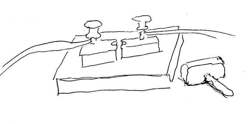

On the page you have suggested me it is written it is 'Used for making or breaking the electrical circuits'can you please explain how?In the image below as per position of key whether current will flow or not in a circuit?I mean if any circuit having key in the position or condition as in image below will have current or not?

The key in this position will have current.

In this position the circuit will not have current,right?
Which way should we rotate it to have current,anticlock or clockwise?or both will work?

In this position of the key in your image, the circuit will have current.
The key is not rotated. The key is removed, in an upward direction, to open the circuit.

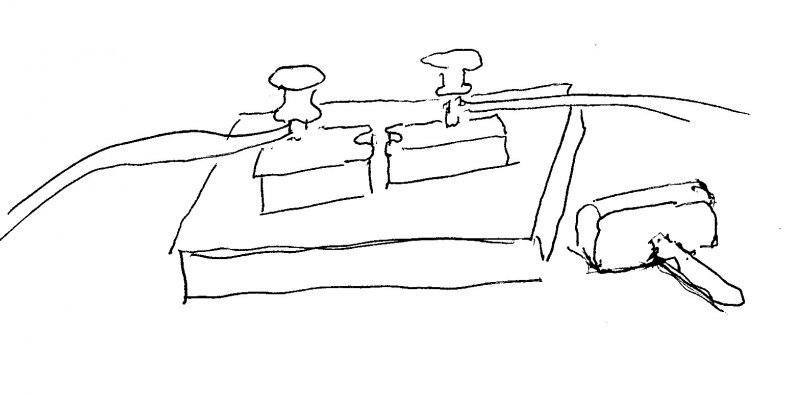

Can you please give me any image (as i have been giving )which will allow no current?

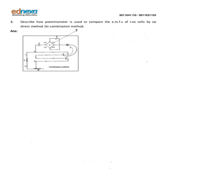

Can anyone please answer what's the square part that I have pointed out in the image below indicates

It's hard to be 100% sure due to the small image size, but it looks like a bridge circuit (wheatstone).
Can not it be DPDT switch?
Yes I suppose that it could be! Well spotted. The presence of the two cells connected to it might indicate that it is meant to reconfigure the voltage source provided to the long-wire resistance, likely by swapping the polarity of top cell's connections in series with the cell to the left of the diamond shape.

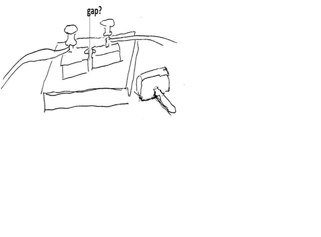

What are gaps in two way plug key ?Can anyone please point out "gaps"in the two way plug key given below?
So,in your image is this a gap?

And in my plug key case
Is this a gap?
OR
No, that's a mounting hole for putting a screw through to secure the switch to the table.
The gap is the space between the conductors.
