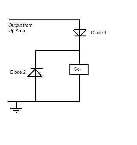

Q1. Why do we connect the Diode 2 in the Op Amp- Relay Circuits? (Check the image )
Q2. Why shouldn't a high current pass through an Op Amp?

Q1: that 'freewheeling' diode belongs to the relay, not related with the opamp. You do that to every relay, to handle the voltage spike when you switch off the relay.
Q2: the load (current, voltage) on the opamp output should be lower than the maximal allowable. The 'high' here depends on the type of the opamp.
Q3: that resistor belongs to the LED, not to the opamp. The current on the LED should be limited, according to the LED type & opamp output voltage.

Q2. Why is there a maximal allowable value?
Q3. My book stated that large currents through LED can damage both Op Amp (Because it is connected in series with LED) and the LED? Is that wrong?

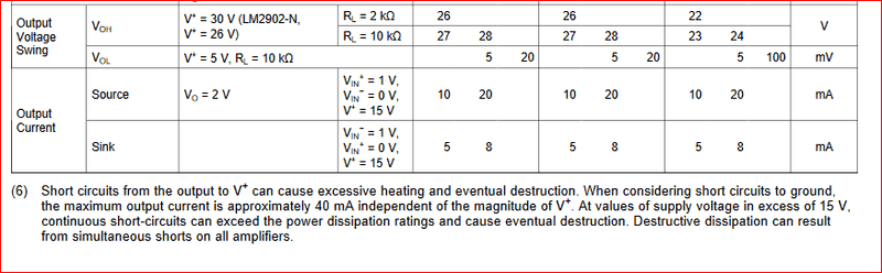

How about if you post an opamp datasheet so we can show you where in that datasheet are the answers to your questions?
eg

Q2: It's what the actual device can/guaranteed to bear at most. The values are available in the device datasheet, or more likely: you will chose devices, which fits your design requirements.
Q3: It's true. However, typically it's the LED which is more sensitive to current, at least while it's still a 'LED' and not a dysfunctional piece of short circuit - which would bring down the opamp too if the limiting resistor is not present.
eg

Have you yet learned "ideal voltage source" ? It can deliver infinite current.
Of course there's no such thing in the real world, but we do use ideal parts in our imaginary thought experiments.
So as rl explained , an ideal voltage source will deliver whatever current is necessary to satisfy its desired terminal voltage. That current might be quite large.
While that large current won't hurt an ideal part it sure could wreck a real one.
The opamp will do its best to mimic an ideal voltage source .
As a circuit designer you don't want your opamp to die trying, so you include in your circuit enough resistance to cause just the right current for just the right voltage. That protects both the opamp and the LED.
It's that simple.
