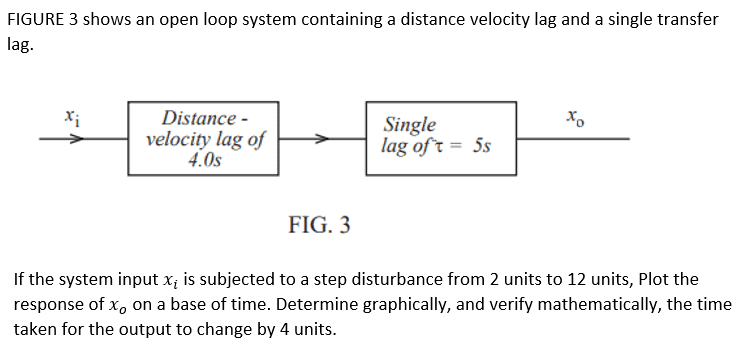

Open Loop system with distance-velocity lag and single transfer lag

If the system input Xi is subjected to a step disturbance from 2 units to 12 units, plot the response of Xo on a base of time. Determine graphically, and verify mathematically, the time taken for the output to change by 4 units.
Output change = input change (1-e ^-t/T)
Hi All, I have got as far as below, would anyone be able to go over this, I am a little confused with plotting this out onto a graph post equation
Any help would be appreciated, I am hoping to get better understanding before I move onto the next question
4 = 10 (1-e^-t/5)
t = -T in (output change/input change)
t = -5 In 6/10
t= 2.55 x 4s = 10.2

Hi Thanks for your reply, Scratching my head with this a bit this is all the info given
Diagram is shown as below
Block diagram of an open loop system: input x_i enters a block labelled Distance – velocity lag of 4.0s, then a block labelled Single lag of T = 5s, producing output x_o.
"Open loop system with a distance velocity lag and single transfer lag"
Question below
"If the system input Xi is subjected to a step disturbance from 2 units to 12 units, plot the response of Xo on a base of time. Determine graphically, and verify mathematically, the time taken for the output to change by 4 units."

Is the original question stated exactly as you posted in post #1? It's incomprehensible as it is. You should ask for clarification.
Another thing to ask is if it is (distance-velocity) lag of 4.0 sec. or distance - (velocity lag of 4.0 sec.)?
Hi Thanks for having a look at this, yes the question is as above, I thought id draw it our rather than copying and pasting direct from the homework statement but see below
Block diagram of an open loop system: input xi enters a block labelled Distance-velocity lag of 4.0s, followed by a block labelled Single lag of tau = 5s, producing output xo. Caption reads FIG. 3.

Then there is a lot that is not sufficiently defined, including:
1) What is ##x_i##? Is it distance, velocity, or both?
2) Is the first block (Distance-velocity) lag of 4.0s? Or is it Distance - (velocity lag of 4.0s)?
3) The second block is called "single transfer lag of t=5s". It is very standard to talk about transport delays, where there is a pure delay of a certain amount, not a lag. Is that what it is? Or is it a Laplace transformation of a first-order lag?
IMO, it is not worth working on this without a clearer statement of the problem.

Your question shows one lag in two steps. I don't believe your question is looking for Output change = input change (1-e ^-t/T).
Then look to plot the step change on a graph and compare your four step change to a value you can find on the graph.
I am currently on this question. It is a distance velocity lag followed by a single transfer lag. Output change = input change (1-e ^-t/T) is used. Any help would be greatly appreciated
I am stuck as to how to properly plot the graph.

Just following on... the distance velocity lag is plotted first followed by the single or first order lag???
