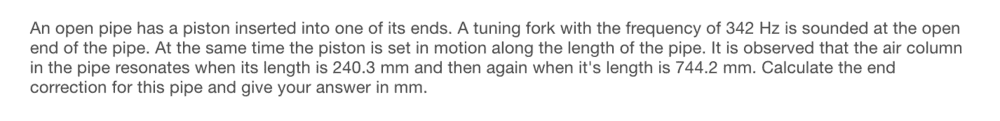

Struggling on how to do this Q

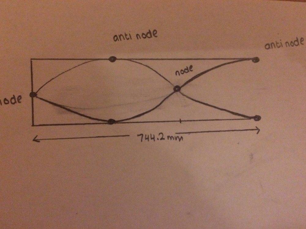

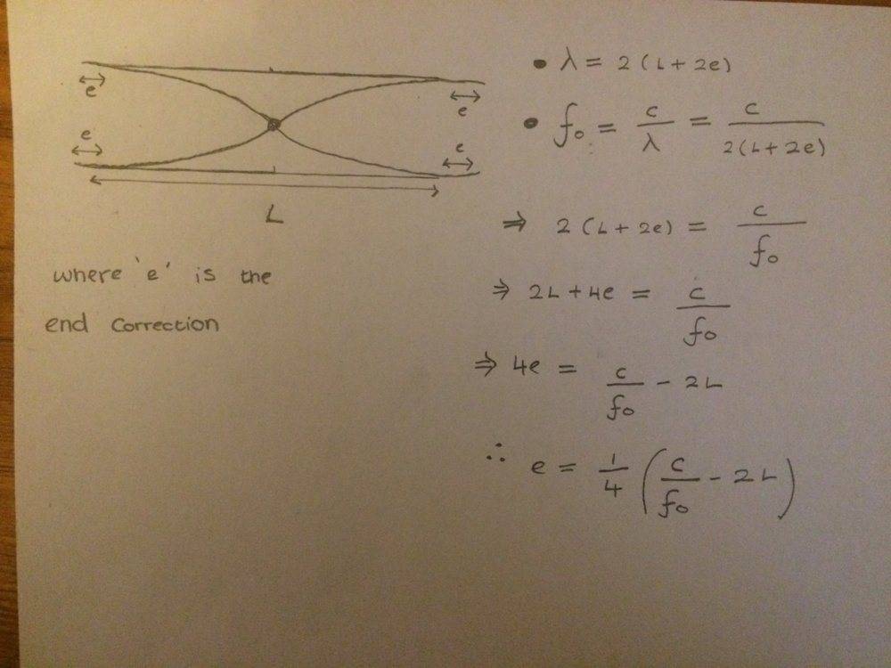

I have tried drawing a sketch of it and had come up with this
This is probably not right, as the speed of sound is not given here as well the length of the open pipe tube?

One end is not open. There is a piston. That will affect both end correction and resonant length.
Ps. Why do they give you two resonances?

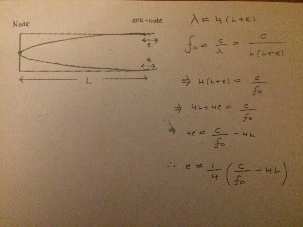

If it is a close end pipe, then the sketch should look like this then
I'm not so sure why myself of why they give 2 resonance here
What do I make out of the 2 resonant lengths given here?
Well, what will the diagram look like for the longer tube resonance?
What do you know about the difference between the two lengths?

The resonance for the longer tube would look something like this?
And the difference between these 2 lengths is half the wavelength in mm
So there you are.

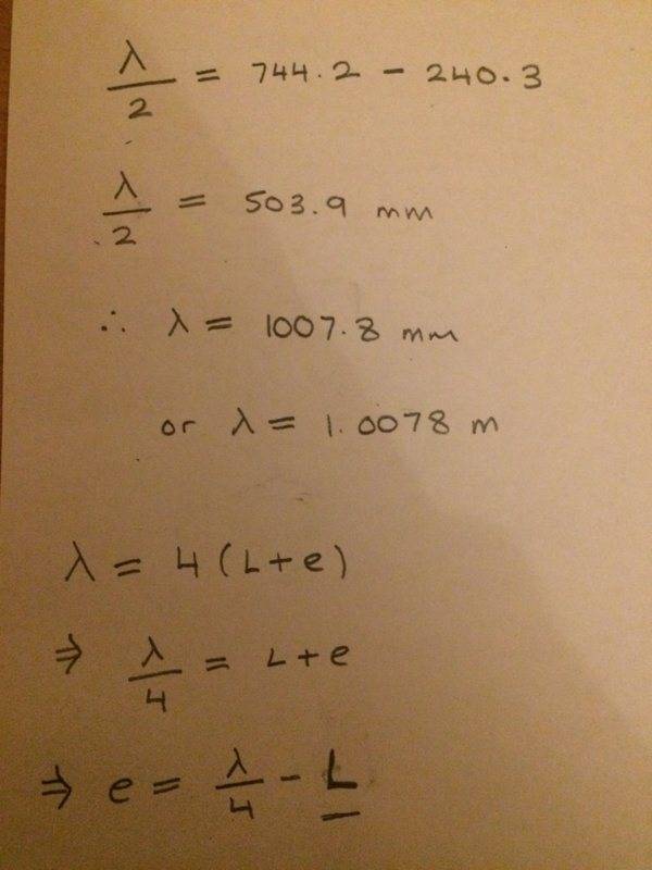

Ok thanks I’m sort of getting it but when I do this
What do I choose my pipe length, L to be?

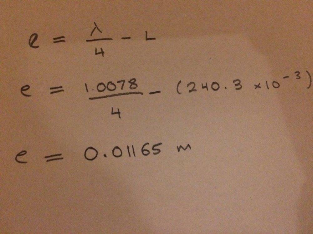

I must let L be 240.3mm to get a end correction, e to be 0.01165m right?
Yes. You could have used the longer one, but that would have been 3λ/4 rather than λ/4
So now you can calculate the speed of sound. Perhaps that's why they didn't mention it?
