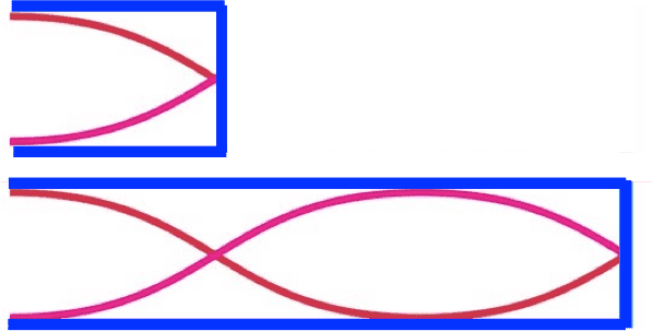

The pipe will resonate at the harmonics of the tuning fork frequency. See picture below. When the pipe length is increased by x, what fraction of the wavelength is added to it?
Two diagrams of a standing wave in a closed-end pipe: a shorter pipe with a single half-wavelength loop, and a longer pipe with a full wavelength of two loops, drawn as red and pink curves.
  • Two diagrams of a standing wave in a closed-end pipe: a shorter pipe with a single half-wavelength loop, and a longer pipe with a full wavelength of two loops, drawn as red and pink curves.
I understand now, when the water surface was at the dotted line, there was still a little bit of space above in the pipe, the sound produced was the first harmonic, then when the water moved down another loud sound was heard: The second harmonic and the difference between the first and second harmonic is half a wavelength.
Therefore x=λ/2
and λ= 2x
