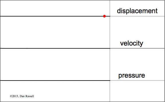

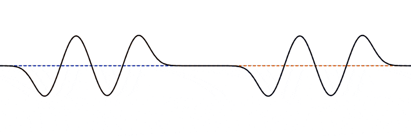

Reflection of a pressure wave on a closed end (bottom graph "pressure"):
Opposing pressure waves (blue & red, with both compression and expansion pressures) crossing each other, resulting in the total pressure (black):

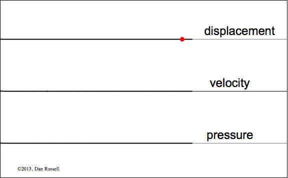

Now, what is different if we replace the closed end with an open end? An open end will reflect the opposite wave, i.e., a compression wave will reflect an equivalent expansion wave, and an expansion wave will reflect an equivalent compression wave.
Reflection of a pressure wave on an open end (bottom graph "pressure"):
The reason a compression wave bounces back on a closed end is to send a message back to the inlet: «There is no way out here, we're pushing everything back out.» With an expansion wave, the message is «We can't pull anything in from here, we're pulling whatever you took back in.»
With an open end, the molecules can exit freely, creating a rarefaction from a compression wave. So they send back this expansion wave saying, «We have an exit here, let us help pull this way.» With an expansion wave, it pulls the molecules in, which creates that compression wave, sending the message «We have an inlet here, let us help push toward your way.»

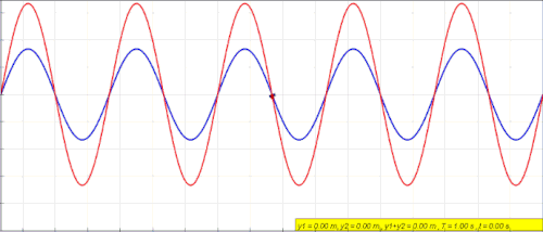

Creating the nodes and anti-nodes of a standing wave coincides with the pressure and reflected waves crossing paths and either maximizing (two compression or two expansion waves) or cancelling (one compression and one expansion waves) themselves. Knowing they travel at the speed of sound, with a fixed frequency of the input vibration, it is just a matter of adjusting the pipe length to locate nodes and anti-nodes such that it enters into resonance. The number of nodes within the pipe will determine the mode.
Animation of a standing wave (red) created by the superposition of a left traveling (blue) and right traveling (green) wave

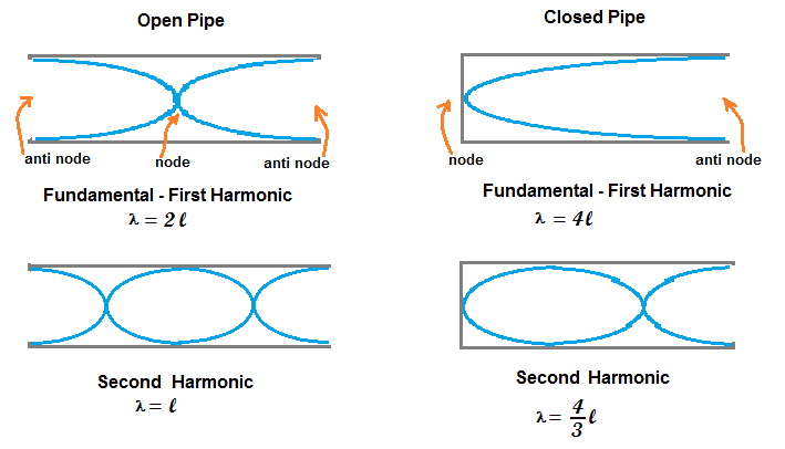

A pipe with one closed end and one open end is the equivalent of a pipe twice as long with both ends open. Instead of going through the long pipe from one open end to the other, and having a node in the middle, the wave travels from the open to the closed end (where there is a node), bounces back, and returns to the original open end. So it is still effectively a pipe with "both ends open".
Watch the second video (Standing Wave Demo: Organ Pipes 2:33) in my previous comment to see the effect of blocking one end (the sound is one octave lower).
I think you are talking about nodes of displacement, while I meant a node of pressure at an open end.
I'm also talking about node of pressure.
For the first harmonic, the open pipe is equivalent to two closed pipes abutted together. Note that if the length of the open pipe ##l_o## is twice as long as the length of the closed pipe ##l_c## , then they have the same wavelength:
$$\lambda_o = 2l_o = 2(2l_c) = 4l_c = \lambda_c$$

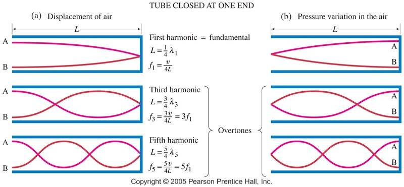

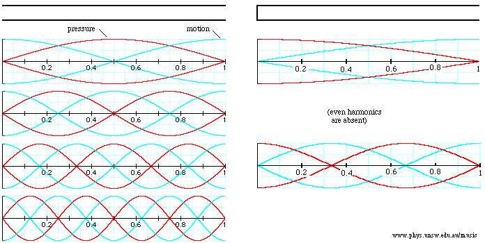

But your diagrams are clearly about displacement, not pressure. Here's the two side by side for a pipe with one closed end:
So just as I was saying, there should be a pressure node at the closed end. But the StackExchange explanation states that just outside the open end pressure fluctuates. That can't both be right, can it?
Sorry, I had it backward; your anti-node comment threw me off. But my logic still applies to what I wanted to say about the equivalent wavelengths:
Clearly, there is always a [pressure] node at an open end, where you have the atmospheric pressure.
