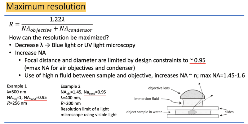

I referred to the professor's slide(attached picture),
but don't understand how NAcond was determined..
So after doing a little research, it seems 0.95 is considered the maximum achievable NA for a dry lens. I couldn't tell you why it's 0.95 and not 0.96 or 0.94. However, the difference between ##NA_{cond} = 1## and ##NA_{cond} = 0.95## is only a 2% change in the value of the resolution. If you want to play it safe, just use the value of 0.95.
