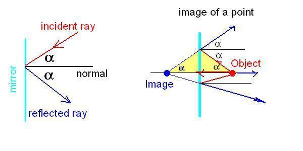

Schumi,
You can solve such problems if you know the basic laws. Those for reflectance from a plane mirror are:
The reflected ray is in the plane defined by the normal of the mirror and the incident ray.
The reflected ray makes the same angle with the nomal as the incident ray, but travels on the other side of the normal. (See the left figure)
The image of a point is there where all the reflected rays cross.
You see an image in the direction of the light rays reaching your eye.
See the right figure that shows the image of a point-like light source. Light rays emerge in all direction and those which reach the mirror, will be reflected. The extension of the reflected rays cross each other at the other side of the mirror: You see the image at the point from where the reflected rays apparently emerge. The yellow triangle is an isoceles triangle: therefore the image is at the same distance from the mirror as the object.
ehild
