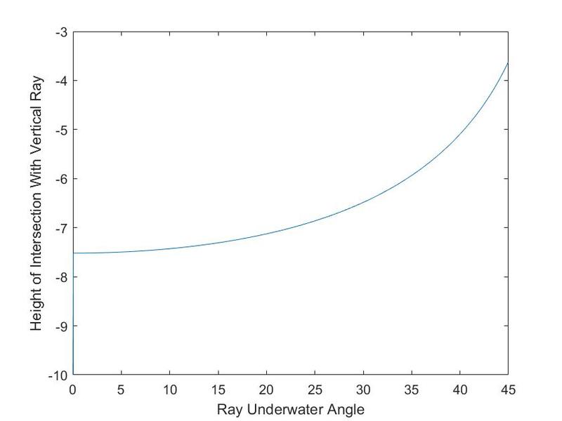

I played around in Matlab and managed to make this graph of the intersection of the virtual ray (the part of the ray traced backwards after it exits the surface of the water) with the vertical ray (Y-axis). I don't know if it's an issue with Matlab that I don't understand or something else, but there's a sharp discontinuity between the initial zero-degree ray and the very next ray. All rays initially started from a point located on the Y-axis -10 units below the surface of the water.
Here's the attached graph.
Line graph of height of intersection with vertical ray against ray underwater angle from 0 to 45 degrees; curve starts near -7.5, rises gently then steeply to about -3.6 at 45 degrees, with a vertical drop at 0 degrees to -10.

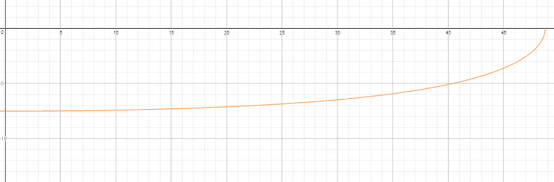

I think it is an issue with matlab, I changed the equation above to angles and made a graph. Weird issue though.
  • Graph of a single orange curve on a grid, with x-axis ticks at 5 to 45 and y-axis ticks at -0.5 and -1.0; the curve rises gently from left to right and steepens sharply near x = 50, approaching the top of the plot.
Did you make this in Matlab? If so, would you mind posting your code so I can see where I might have gone wrong?
No sorry, I didn't use Matlab. But I think the problem is when you asked the program to trace backward the perpendicular it self and somehow it chose the value -10. However the function there is discontinuous and I don't think MATLAB interprets discontinuous functions, so It just makes vertical lines. I have googled it and it seems this what it does
OK, so what you guys have are the vertical positions at which the refracted rays intersect the vertical axis (on which underwater object lies), when extended "backwards" into the water. I did the calculation in MS Excel and got a graph similar to Drakkith's, but with discrete points instead of a continuous curve. I maintain that these positions should not be considered to be apparent image locations. For that, you need to consider a narrow bundle of refracted rays, and see where they (approximately) intersect.
Try calculating the refracted rays corresponding to e.g. the underwater rays at 10° and 11°, and find where they intersect each other. Repeat for various other pairs of 1°-separated underwater rays. If the angles are small, the intersection points should be close to the vertical axis, and close to the vertical positions you've already calculated. For larger angles, they will be away from the axis, and at significantly different vertical positions.

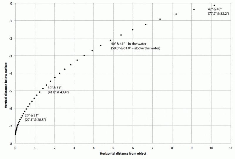

Deja vue all over again, to quote Yogi Berra. I posted the following in this previous thread: https://www.physicsforums.com/threads/apparent-depth-conceptual-question.866441/#post-5439807
Thinking about this some more - what I wrote was true if you just used the vertical ray and a non-vertical (oblique) ray from the point on the fish, using a giant eye. If we just consider the oblique ray, as you increase the angle from the vertical the refracted ray, when followed back into the pool, will be higher and higher above the fish. So the answer to your question is no - they rays would not trace back to a single point above the fish when a large spread of rays from the fish are considered, which is what BvU may have been alluding to.
Realistically, as you look into the pool, rays with a single oblique angle and a small spread about that angle are entering your eye. You follow them back into the pool to locate the image of the point on the fish. As you move further away i.e larger ray angles to the vertical, the image moves up toward the surface of the pool. I've been playing with a spreadsheet that I created to calculate the location of the image and it does appear that it shifts to the right , as in your third diagram, as you move more to the right. Maybe someone else can confirm this.
For what it's worth, here's what my spreadsheet produces for the example in this thread (object at x = 0, y = -10). I calculated the image locations for all consecutive 1° pairs of rays, referring to the angles inside the water. Some of the points are marked with the angles inside the water and (in parentheses) above the water.
Scatter plot of image locations from refraction at a water surface: horizontal distance from object against vertical distance below surface, with points curving from near the bottom left up toward the surface at upper right. Labelled angles mark several points.
