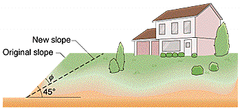

A house is built on the top of a hill with a nearby 45° slope (Fig. 6-19). An engineering study indicates that the slope angle should be reduced because the top layers of soil along the slope might slip past the lower layers. If the static coefficient of friction between two such layers is 0.67, what is the least angle through which the present slope should be reduced to prevent slippage?
(I attached an image. Hopefully it shows up - You may have to click the attachment once more after it comes in the pop-up)
f = μn
f = mg*sin ∅
n = mg*cos ∅
Current value of ∅ = 45°
μ = 0.67
I drew a free body diagram, and found that the friction force is equal and opposite that of mg*sin∅, and that the normal force was mg*cos∅.
I then set up this equation:
Net force = f - mg*sin∅
μ*n - mg*sin∅ = 0
μ*n = mgsin∅
μ*mgcos∅ = mgsin∅
(mg's cancel)
μ * cos ∅ = sin ∅
μ = tan ∅
tan-1 μ = ∅
I plugged in 0.67 for mu, and got 33.822°, which I am being told is wrong.
Can somebody please help me? I have one more submission left.
  • Diagram of a house on a hill with a dashed line marked Original slope at 45° and a second dashed line marked New slope, shallower, with angle θ labelled at the base.
Looks like you solved for the correct angle to me.
Are they asking how much the angle should be reduced by? Or reduced to?
