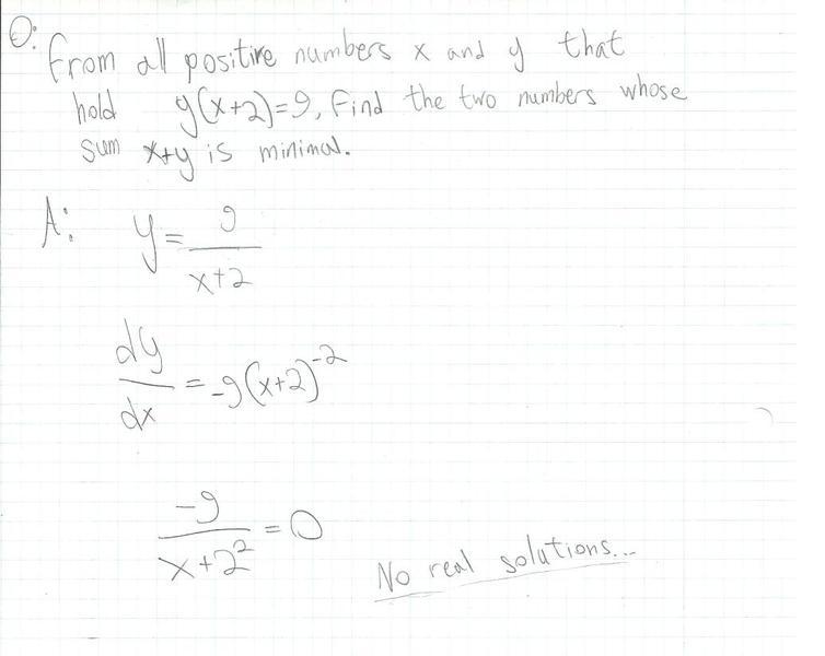

From all positive numbers x and y that hold y(x+2) = 9 , find the two numbers whose sum x+y is minimal
Attached. My idea here is to take the derivative of y with respect to x, and set it equal to zero. This is how I understand you solve for optimization problems and find minima and maxima. Have I set the derivative correctly? I think my idea is correct, but the way I practically approach it isn't.
Will appreciate any hints and directions I can get :)

You want to minimize f(x,y) = x + y; how can you write f(x, y) = x + y as a function of one variable?
Be careful, you are not trying to optimize the constraint itself, but rather another function subject to the constraint.
You have two ways to solve it.
You are trying to find the minimum vale of [tex]S(x, y) = x+y[/tex], subject to the constraint [tex]y(x+2) = 9[/tex]. So one way would be to solve for [tex]y[/tex] in the constraint and plug this value into [tex]S(x, y)[/tex], from which you get a function of [tex]x[/tex], which you optimize using differential calculus as you have tried in your attempted solution.
The second way would be to use Lagrange multipliers - I assume you have not taken multivariable calculus yet, so I will not elaborate to confuse you. However, if you have taken multivariable calculus (or are covering it now) or wish to see how the Lagrange multiplier method works, just say it and I'll explain how it's used.
Best of luck. :)
So the function you would try to optimize is:
[tex]f(x)=x + \frac 9 {x+2}[/tex]
Can you take the derivative of that?
And solve it for being equal to zero? That is: f'(x) = 0

Reading all the replies gave me the clue in. So basically, I try to minimize x+y, and I was given a function that is my constraint. So, all I have to do is rewrite the y in the formula as 9/x+2, that being the constraint, like ILS suggested. Aha! So I did have the right idea of how to solve it!
I'm off the scanner for today, but setting the derivative to zero I did get x=1 and x=-5. Since they said only real numbers, I remove x=-5. Plugging it into the original formula I get y=3. So, answers are, x=1 and y=3
That's true according to the manual! :)
Wait there's one more thing, they're asking for the minimal value of x+y... er...what does it mean? Should I just do... 1+3 = 4?
Because the answers manual says the answer to this question is indeed 4...but it seems like a stupid question.
Anyway, thanks for helping me see it through! :D
:smile:
They said "only positive numbers", so your conclusion is correct.
(However note that "real numbers" can also be negative.)
*pout* it's not stupid :wink:
But yes, that is correct :smile:
