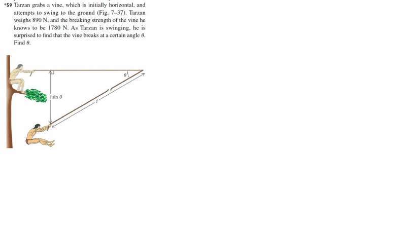

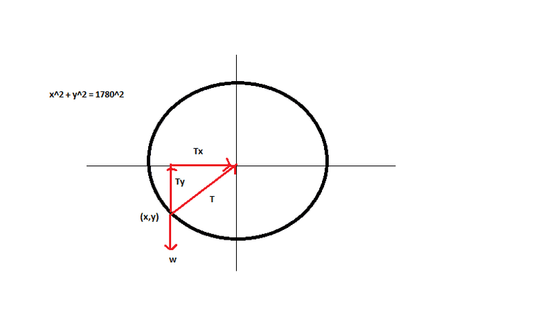

I added two pictures.. One of the word problem and one of my diagram I made..
My work:
1.Wnet = Kf - Ki
-Ugf = Kf... -mgy = mv^2/2 ... - gy = v^2/2
2. x^2 + y^2 = 1780^2
dy/dx = -x/y = velocity (v) at point (x,y)
3. gy = x^2/(2y^2)
4. gy = (1780^2 - y^2)/(2y^2)
... anyways... I know this must be totally wrong..
Can someone please help me answer this problem?

"And if x and y are coordinates in (2), how did you relate them to a force of 1780 N."
I related 1780 to (x,y) by saying the end point of tension started at the origin, and because the motion is a circle I gave the following equation...
x^2 + y^2 = 1780^2... which relates it to x and y... would this not be correct?
Can it be that you intended Tx^2 + Ty^2 = 1780^2?
x and y would be coordinates that have "meter" as the unit.
1780 is the critical tensional forces that has "Newton" as the unit.
Tx and Ty would be the cartesian force components of the tensional force.
They also have "Newton" as the unit.

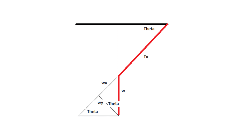

Tx should be T

im saying x and y because i labeled it with the following axis..
