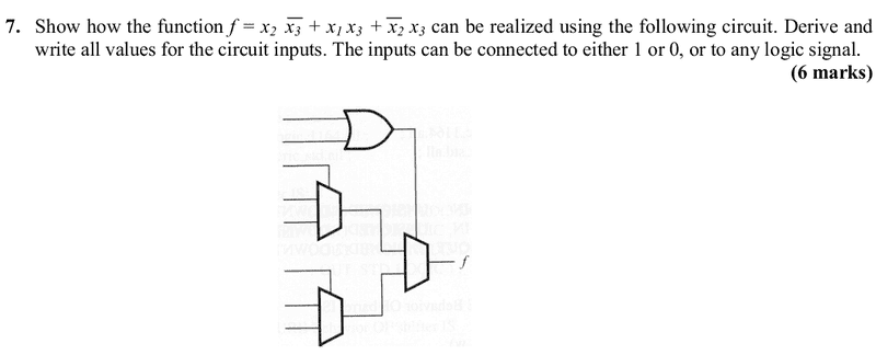

The multiplexer that is closest to the top of the page has ~x3 as an input but I am not allowed to use the negation of a logical variable as an input. Any way to get rid of this negation?
It's tough to give you assistance on this without giving you too much of a clue.
Notice that the only way you can invert a signal is by using a multiplexer. Also, the solution I found is based on [itex]x_3(\bar{x}_2+x_1) + \bar{x}_3x_2[/itex].
