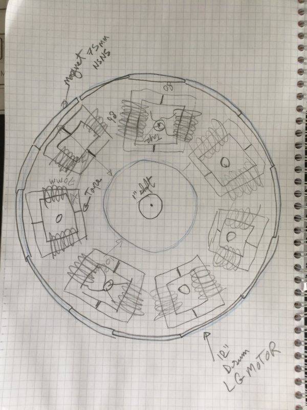

Hello All,
am trying to make my own Generator 5kw , am trying to find out how many coils i need , i have a drum which is full of magnet 48 NSNSNS...

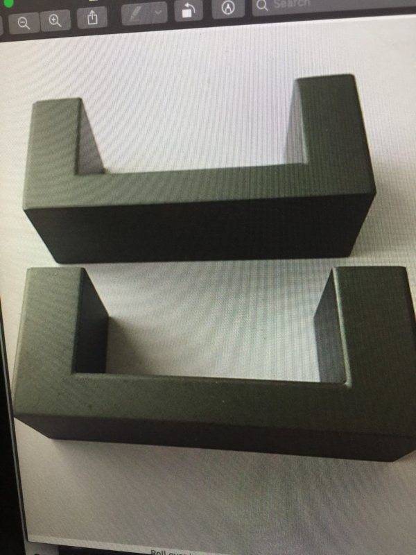

for the coil i have 8 cores U shape U86A size of section is 15 cm ( 56x28mm )
how to find out what gauge for the magnet wire and how many turns
and how much they will give max as voltage and amps ?
for example if i put AWG 18 wire ( 1 mm ) what would be the amps and voltage ? my hand drawing showing the drum where all the magent will be turning and the coil inside fixed

There is no where near enough information in the post to even begin to answer that question.
If DIYing something, the approach I'd take is put a known number of turns, eg 1turn per coil. Rotate the system at the desired speed then measure the resulting voltage. From there you can calculate the number of turns needed to reach the target voltage, once you know the turns count needed, you can work out your maximum wire size to get to a decent fill factor in the coils.

V=N*(dΦ/dt), N = turns count, dΦ/dt is rate of change of flux the coils are exposed to.
Maximum current is determined by the heat dissipation capacity of the machine.
a lot of unknown this way , if i assume the Φ ( thickness of the wire ) =0.72 x Squar of the amps so if i want 2 amps then the thickness of the magnet wire need to be 1 mm is that right ?
and if i assume the section to be 15 cm square then n=k/s so k=45-50 so number of turns is = 45/15 = 2.8 turns per volts
so for 50 volt i would need 18 turns of wire AWG 17 , how far am i ? is that calculation is right >?

Find the numbers by winding a 10 turn coil from thin wire. When you spin the alternator at its expected lowest operating RPM, measure the open circuit voltage produced.
You can then work out the number of turns needed. Work out the current from amps = watts / volts. Select from wire tables a gauge that will carry that current.
https://en.wikipedia.org/wiki/American_wire_gauge#Tables_of_AWG_wire_sizes
Work out the length of wire needed to put that many turns on your coil former. From that work out the resistance. Some voltage will be lost in that resistance; Vloss = ohms * amps. Add another turn or two to make up that lost voltage. Power loss will be; watts = amps * ohms2Work out the cross section of the winding and check that it will fit on the core. Select a bigger core, or recompute with thicker wire until you have an optimum solution with minimum power loss.

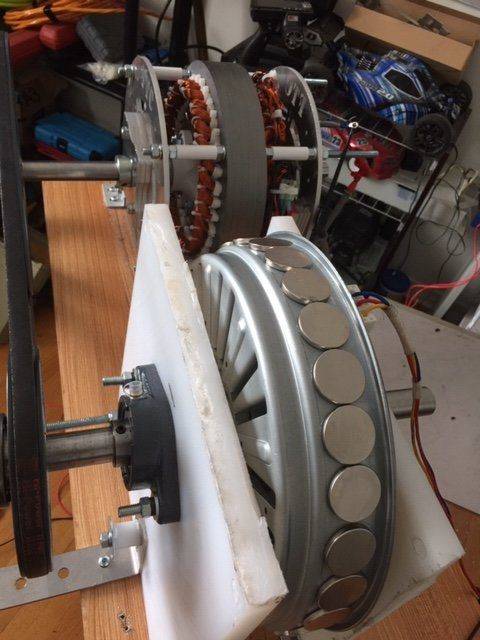

The LG motor has the number of poles on the three phase stator closely related to the number of PM poles on the external rotor. The sketch you provided shows few (7) magnetically closed coils being passed externally by many (48) closer pitch magnetic poles. That will be very inefficient. You will need to modify your proposed magnetic circuit. Start by tracing the magnetic paths in the LG motor. Mark the alternating N S poles on the rotor with different colours, then notice how they pass the stator poles and the way the poles are wound.
The large diameter of the LG motor means it is only a low RPM motor. It will not survive high RPM. You might consider rewinding the original LG stator to get the voltage you require at the RPM you will drive it. The stator section available to enclose the windings limits the power that can be generated efficiently. I would be surprised if the LG stator could generate more than the 750 watt it was engineered to convert. To increase power you would need to proportionally lengthen the motor, (wound stator and PM rotor), to increase the area available for the windings.
@Baluncore hi, so what is the rule to match the coil with the poles? i have 48 poles NSNSNSNSN... do i need 48 coil ? the LG motor have 36 coil and 48 poles
the coil in the LG motor is not good to do a generator , max is 1200 Watt , so what i want to do is i do an ANT LEnz coils a new design ,
can you tell me what is the rule of the number of coil versus the number of the poles ,
Your cores look like ferrite, which would be essentially worthless for your generator project.
can you explain why ? what if its nanocrystal ?
The LG direct drive motor looks like the F&P smartdrive motor developed in NZ.
Check the counts. 36 coils will probably make three phases, each of 12 coils in series. The magnetic rotor will need to have 12 N-S magnets that repeat every three coils. That makes 24 magnetic poles, not 48. The 24 pole rotor could be a ring of 12 flat magnets stuck on a magnetic backing plate. Hold a magnetic wire near the rotor to feel and identify the magnetic poles.
Each coil is wound on a stator pole. Follow and visualise the magnetic field lines from a N pole on the PM rotor, across the gap into the stator core, then through the laminated core surrounded by a winding, probably splitting in two before returning back across the gap into the adjacent S poles on the PM rotor.
Each time the rotor moves by one magnetic pole, the field reverses through each coil.
Each time the rotor moves by one N and then one S pole, it produces one cycle of AC voltage.
I expect every third coil on the LG motor is wound in series to produce one phase. All those poles in series produce the output voltage in phase. Three phase requires the number of coils be a multiple of three. Every third coil should be opposite a N pole at the same time.
7 coils will not work efficiently with 24, 36 or 48 poles because 7 is not a factor of 12 and the poles need to line up. Notice that as the PM rotor moves through each magnetic cycle, it sequentially passes three evenly spaced windings, to generate the three phase voltages separated by 120°.

@sophiecentaur i have that Motor LG washer machine and as a prototype i put on the outter surface NYD 52 NSNSNS... and i made a small coil " Anti lenz " ONE coil and it was making 24 volts 1 amp and raising the input of the motor 3 watts only so open circuit 24 watt for 3 watt and my core was just alan key , so i think the nanaocyrstal will be better and i will put the coils inside instad of outside , i work in electromechanics but am not into motors and generators
so now i need to do factor of 12 for my coils , my question is how to determine the number of turns i decide to go with AWG 18 , or maybe i can go with AWG 24 + AWG 18 together one for volts and one for current but how many turns ?
