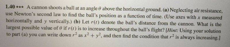

Hint given in problem statement

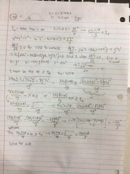

Quadratic formula
The correct answer is theta = 70.5 degrees. I'd like to know if I'm on the right track. Do I simply solve for theta? Is there a better approach that circumvents all of this messy algebra? Much appreciated!
Oops! All wrong. My bad. Please ignore

You do not need to solve the quadratic. If r is always increasing the quadratic has no solutions. What condition on the parameters leads to that?
