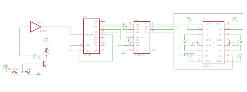

Im working on a project which cycles through stop,forward, back,left, right modes of a bot using light pulses as input .
light source is laser pointer , room is dark
the circuit is not mounted on the bot
the circuit -
light pulse -> ldr-> bc337transistor ->7404 NOT -> 4017 decade counter ->7483 full adder -> l293d (10Volt)-> bot
bug - the 7404 inverter out is rising even at falling edge of light pulse
however it works fine with motor supply =6 v and also when dc motor is not connected to l293d
is the circuit correct?
schematic-https://drive.google.com/open?id=0B5m-h82V0Ej2N2kzVWE1UDR0WDg
any thoughts how to reduce noise in the circuit

post schematics in the thread
DONT force people to sign up to www sites just to see an image or 2
how are you going to the problem of ambient light affecting the receive side in the bot ?
that is going to be your first major problem

and as I asked ... PLEASE post the schematic(s) in this thread
