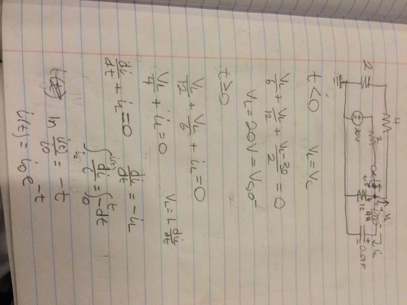

Hello, I am working on this problem
I am having some difficulty finding the right answer. A few points I'd like to expand on so that one can understand my thought process. First off, there is a standard table with the solution to series RLC circuits. I don't think I can use that table with what I have in this circuit. So one idea I have us to modify the circuit to look like what I want with a thevenin equivalent.
If the thevenin idea is wrong, I did nodal analysis and this is what my attempt looks like.
I get an expression but the initial current is Zero, which proves troubling to integrate. I also can't tell the nature of damping in this circuit either

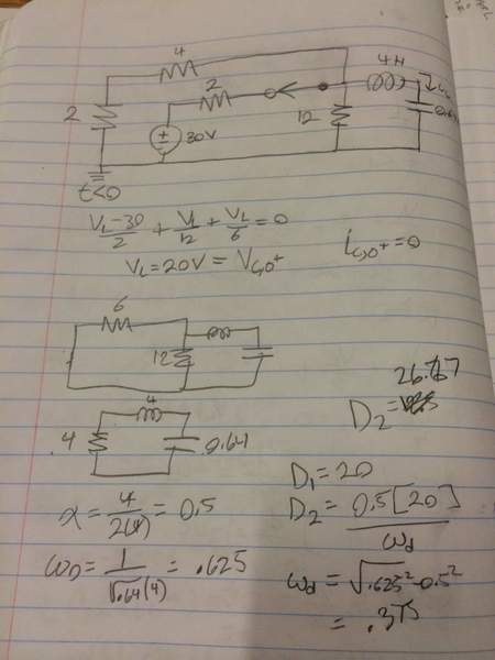

I tried again with the thevenin, which brings me closer to the answer, but their value is
-13.33e^(-.5t)sin(.375t)
Mine is almost the same, but I have that extra -7.5 term that they don't. I get -20.83e^(-.5t)sin(.375t)

At t=0 the capacitor is, presumably, fully charged, so the inductor current and voltage at this time will both be 0.

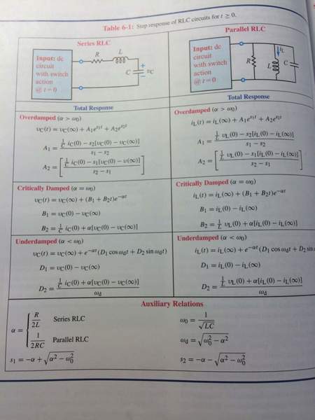

It's a second order system, so the response will be a decaying sinusoid. Where did you copy the general solution from?
What is alpha described as?
Here is the table
Alpha is the damping coefficient

Possibly not. Coefficients are usually dimensionless. Your alpha has units of sec⁻¹.
Your method looks right, but you haven't finished. To determine ic you now have to multiply that derivative by C.
