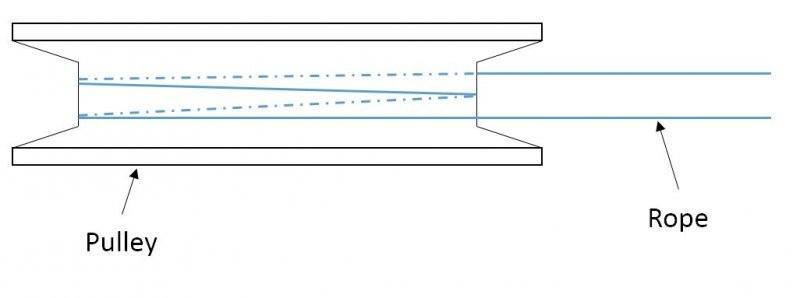

I need little help currently I am working with on a Project that includes Motor Pulley and rope combination. The previous version of our Test bench was having a Motor pulley and rope and the rope was wrapped around the pulley as in most of the cases, but now I am trying to optimize it and want have two wraps of rope around the pulley (as shown in the photo). The pulley will rotate with 70 km/h speed. I just need your suggestions what steps can I take to avoide the overlapping of rope during rotating and which angle should I use between the wraps to get optimium results. During the whole process of rotating the rope will be under tension. Any suggestions will be greatly appreciated. Thankx in advance.
You could use some type of physical separation system such as a couple of eyelets just outside of the pulley to maintain the proper orientation.
Hi first of all thank you for your reply. Can you please explain me what you exactly mean by eyelets?
In this case, for simplicity and low cost, I was specifically thinking of "eyelet bolts" screwed into a chunk of 2x4 or similar. An eyelet bolt is essentially a "lag bolt" that has the head cut off and is bent around into a shape like a question mark but closed all the way back to the stem. Another example of eyelets are the line guides on a fishing rod.

I think your idea of eyelet Bolt won't work. Because when I will attach it on the pulley surace and as the pulley will rotate it will also destroy the shape of the rope. So I think it will work in opposite way rather that maintaing the rope in position. As shown in the picture, if I add eyelet bolt on the black spots and when the pulley will rotate it will come in between the rope shape. The rope is 200 meters long, one end of which is connected to a horizontal platform and other end after traveling around another pulley at other end will attach to the second end of horizontal platform that will move 80 kgs of weight with 70 km/h, so my only and primary goal is the rope should remain in this position through out the function..
No! No, no, no, no, no! :oldsurprised:
The eyelets are supposed to go where the arrowhead from your "Rope" label is, one for each blue line.
aaaaahhhh ok I understood now. Thankx a lot buddy

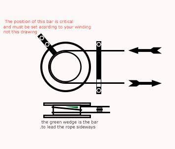

Here I am again we constructed the thing n tried to rotate at high speed but the rope overlaps each other at high speed even if we use eyelets. I am thinking a lot about other concepts but m not getting anything can you please help me. Do u have another idea regarding the concept. Pls help
the speed and tension are going to keep making this fail. the rope doesn't have time to self correct before the spinning locks up an errant position.
my only idea would be slip guides which is another form of the eyelets approach.
with a polypropylene wedge forcing the rope to go sideways on the pulley at the point where it needs to kick over with a bar with polypropylene pads between the two in and outbound ropes on the front end of the pulley may keep it from overlapping .the wedge as the bar are solid mounted off the pulley.

something like this should help guide the rope its possible you might need 2 wedges to really keep it from overlapping:
