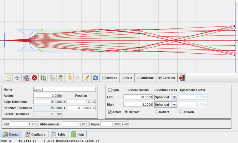

I am trying to design an acrylic light pipe that has a 3W power red LED input with 60 degree beam angle.
I need a reasonably collimated exit light beam or at least a narrow angle output.
What I'd like to know is - what is the optimum shape of the exit end of the light pipe to produce the narrowest beam?
The first iteration is with a hemispherical exit. but I suspect that might produce total internal reflection for shallow angle rays at the edge and perhaps a wide angle beam.
Can anyone please suggest a better shape? Flat or convex may well be better, but I cannot afford a ray tracing program to verify this.

Redron said:
No, the light pipe is necessary to insert the light source to the proper location.
The light pipe you have drawn is just a straight piece of plastic. If you really want to maximize the light, use the biggest pipe you can, put the flat back end flush on the unfocused LED and convex curve the front end to image the big multi-die LED onto your target. Just like a lens. In fact the easy way to build this is to glue (optical epoxy) a polycarbonate plano-convex lens onto a polycarbonate dowel. Glue the dowel on the LED also if you can. No lens on LED. The radius of curvature of the light pipe lens lens will be given by the Gauss formula for a single surface refraction.
You will be amazed by how much light pipes don't like to concentrate light...good luck.
I just saw your post after playing with one of the free ray tracing packages (Optical Ray Tracer 9.6) that berkeman suggested (Thanks berkeman).
It really does show how TIR sends light into all directions, as you pointed out.
This is the best simulation I can muster given the constraints, and I'd be happy with this outcome.
It diverges from your suggestion of removing the lens (which is already bonded to the LED) - an act that would expose the bonding wire and chip (!)
Given that the LED already produces a fairly narrow 60 degree beam, then having a convex collimating entry to the light pipe will allow most of the light to reach the other end without suffering TIR, resulting in a fairly parallel beam which can be focused by the desired amount.
The concave lens represents the LED emission pattern.
I know that this goes against all recommended light pipe design dogma, but this requirement is very different from the normal light pipe application. It is more like a very thick lens.
