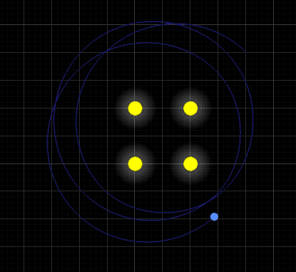

You could try the gravity simulator at www.testtubegames.com.
It doesn't support cube planets but you can place several "fixed stars" close to each other and then make a planet orbit around them to achieve a similar effect. If the distances are large enough there is no noticeable difference from a planet going around a single spherical star. But if the distance is small you get an orbit that is not elliptical and doesn't close. Here is a screenshot.
Likes mfb
