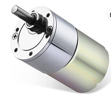

Servo and stepper motors are overkill for applications that run at a single speed. Look for a gearmotor (search the term). A gearmotor is a motor combined with a gear reducer. A quick search found this on Amazon: https://www.amazon.com/dp/B0721T1PXQ/?tag=pfamazon01-20
I have no idea if this one meets your needs, nor do I have any knowledge of its quality. It's just the first one that popped up on a search for gearmotor with 100 RPM output. Given the low price, you might consider just buying it (or a similar one), and find if it works.
