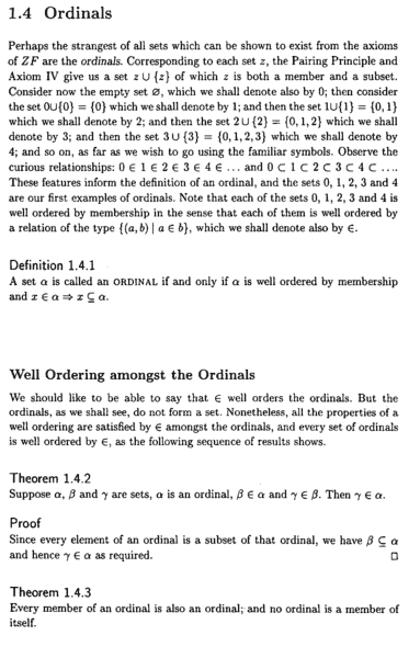

I am reading Micheal Searcoid's book: "Elements of Abstract Analysis" ... ...
I am currently focused on understanding Chapter 1: Sets ... and in particular Section 1.4 Ordinals ...
I need some help in fully understanding the Corollary to Theorem 1.4.4 ...

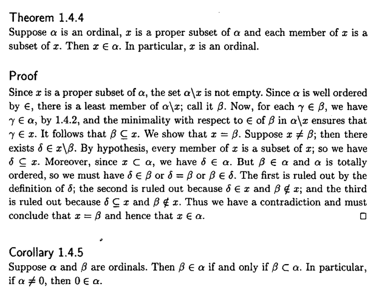

Theorem 1.4.4 and its corollary read as follows:
Searcoid gives no proof of Corollary 1.4.5 ...
To prove Corollary 1.4.5 we need to show ##\beta \in \alpha \Longleftrightarrow \beta \subset \alpha## ... ...
Assume that ##\beta \in \alpha## ...
Then by Searcoid's definition of an ordinal (Definition 1.4.1 ... see scanned text below) we have ##\beta \subseteq \alpha## ...
But it is supposed to follow that ##\beta## is a proper subset of ##\alpha## ... !
Is Searcoid assuming that ##\beta \neq \alpha##? ... ... if not how would it follow that \beta \subset \alpha ... ?

============================================================================It may help readers of the above post if the start of the section on ordinals was accessible ... so I am providing that text as follows:
Hope that helps ...
Peter

For the forward direction ##\Rightarrow## of the equivalence ##\Leftrightarrow##, having ##\beta=\alpha## together with ##\beta\in\alpha## would give us ##\alpha\in\alpha##, which would contradict Theorem 1.4.3.
For the reverse direction we just use ##\beta\subset\alpha\to \beta\subseteq\alpha## and proceed from there.

Just another question ... the Corollary goes on to state that, in particular, if ##\alpha \neq 0## then ##0 \in \alpha## ... can you help with the proof of this ... ?Thanks again,
Peter
0 is the empty set, which is a subset of every set, so in particular ##0\subseteq\alpha##. Putting this together with ##\alpha\neq 0## gives ##0\subset\alpha##. Applying the corollary to that with the arrow pointing left gives us ##0\in\alpha##.
