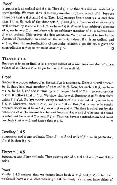

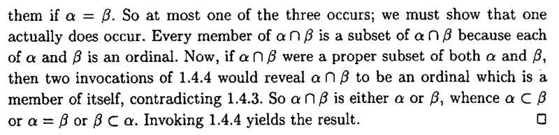

I am reading Micheal Searcoid's book: "Elements of Abstract Analysis" ... ...
I am currently focused on understanding Chapter 1: Sets ... and in particular Section 1.4 Ordinals ...
I need some help in fully understanding Theorem 1.4.6 ...

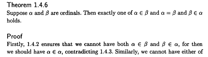

Theorem 1.4.6 reads as follows:
My question regarding the above proof by Micheal Searcoid is as follows:
How do we know that ##\alpha## and ##\beta## are not disjoint? ... indeed ... can they be disjoint?
What happens to the proof if ##\alpha \cap \beta = \emptyset##?
Help will be appreciated ...

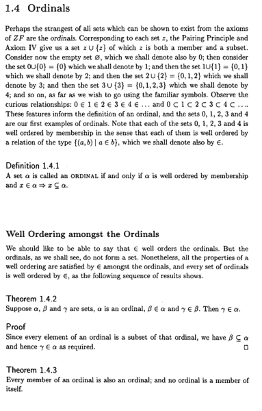

==========================================================================It may help Physics Forums readers of the above post to have access to the start of Searcoid's section on the ordinals ... so I am providing the same ... as follows:
Hope that helps ...

They can be disjoint. If they are disjoint then ##\alpha\cap\beta=\emptyset## which is the ordinal 0. The proof still works.
To get a feel for this, consider the case where say ##\alpha=0=\emptyset##. If you follow the proof through with this, you'll see that it still works and that either ##\beta=\alpha=0## or ##0=\alpha\subset\beta##. The empty set is a subset of every later ordinal, because it is a subset of every set. More generally, every ordinal is a subset of every greater ordinal.
