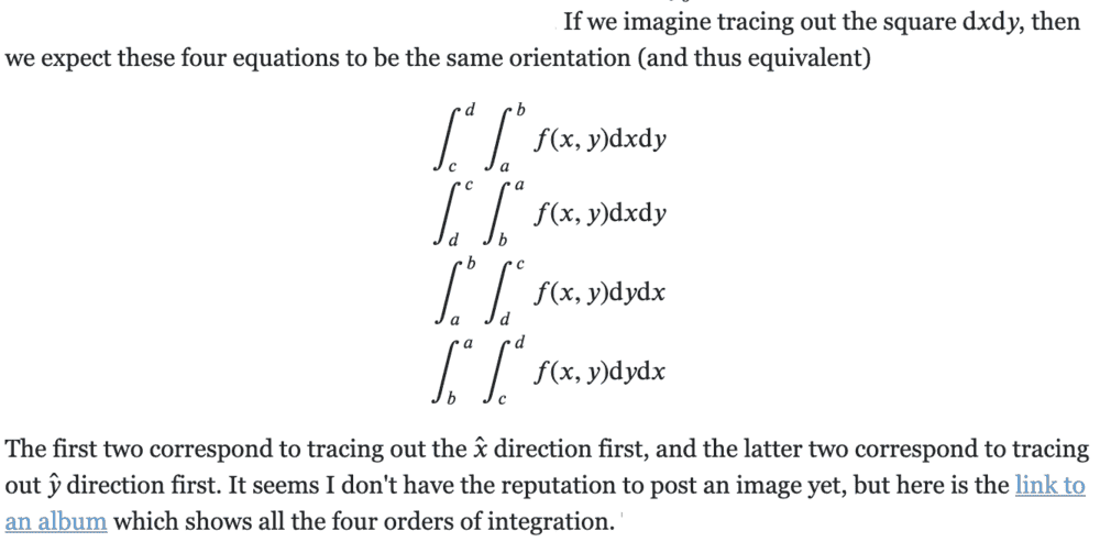

Thanks. I saw one explanation on MSE (link here) which claimed that the following two integrals should be equal because they both "go anticlockwise".
I'm not sure if that's correct.

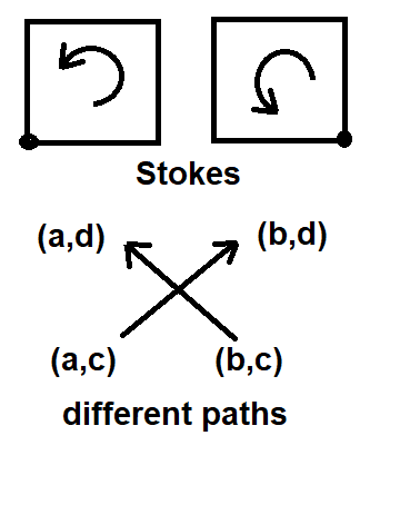

If you integrate over the entire area with the help of Stokes theorem, then both are equally oriented. If you only integrate half of the paths, from ##(a,c)## to ##(b,d)## or from ##(b,c)## to ##(a,d)##, then you get different signs:
Try a parameterization of the integration paths in your examples and integrate along one variable.

Yes, you need two parameters for a surface, or Stokes to reduce the problem to the boundary, which is why the surface integral equals ##\int_0^1\int_0^1f(x,y)\,dx\,dy##. The orientation is determined by ##[0,1]\times [0,1]## as opposed to ##[0,1]\times [1,0]##.
In one dimension we have ##\int_a^b f(x)\,dx = F(b)-F(a)## or if the path is closed ##0= \int_a^a f(x)\,dx =\int_a^b f(x)\,dx +\int_b^a f(x)\,dx.##
However, if you only integrate along the vectors without going back and thus double the minus signs, then it is a line integral ##\int_{(a,c)}^{(b,d)} f(\vec{x})\,d\vec{x}\neq \int_{(b,c)}^{(a,d)} f(\vec{x})\,d\vec{x}## with two different parameterizations.

The orientation of the surfaces (squares) in your example are given by ##(1,0,0) \times (0,1,0)## on the left and ##(0,1,0)\times (-1,0,0)## on the right, which are equally ##(0,0,1).##
I feel like the picture was just trying to get at the reverse of one of the x and y directions of integration when you do dydx, and it confused fresh whether you were talking about a path integral around the boundary or something.
I think the discussion is about the question: "Why does swapping integration order does not swap the sign while ##dx\wedge dy = -dy\wedge dx\,##?" And the answer is, that we did not swap the signs of combined length and height (see the calculation in post #9) in the first case (Fubini), but did so in the second (Graßmann).

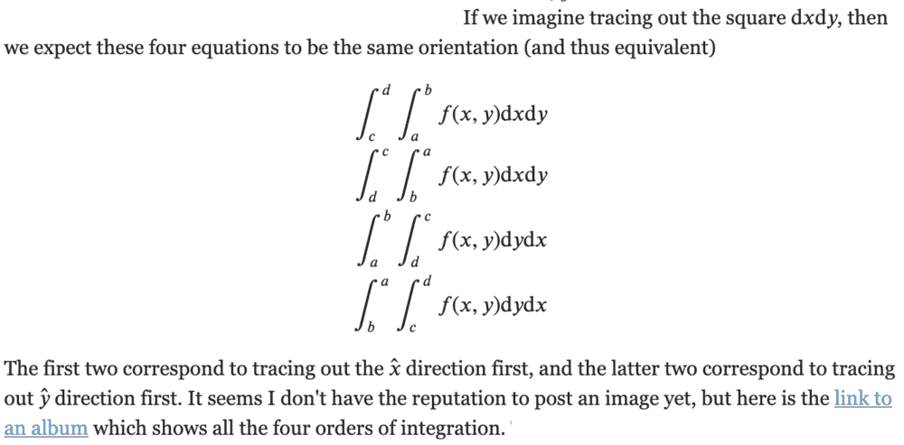

I think I understand it slightly better now. I was just trying to understand what this meant:
because it seems to say all 4 are equivalent, but to me at least they are not.
The first two are equivalent and the last two are, assuming that the function allows changing the order of integration.

Yeah, that's what I had in mind. We start off with the multiple integral over the region ##R = [a,b] \times [c,d]##,$$I = \int_R f(x,y) \, d(x,y)$$Then Fubini allows us to re-write this as an iterated integral,$$I = \int_{c}^{d} \left( \int_{a}^{b} f(x,y) dx \right) dy = \int_{a}^{b} \left( \int_{c}^{d} f(x,y) dy \right) dx$$where I've put in the brackets, but they're often left out. Once in this form, we can just use the property that ##\int_a^b f(x) dx = -\int_b^a f(x) dx## to obtain other equivalent expressions, e.g.$$I = \int_d^c \left( \int_b^a f(x,y) dx \right) dy$$
