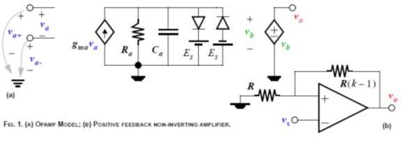

Hi everyone, I need help with this exercise becouse I don't know how to calculate the equilibrium points of a circuit. The original exersice is the following:
Assume that the open loop dynamic response of the OVA-opamp gets captured by Fig. 1(a) and
consider the circuit of Fig. 1(b).
Consider first that vs =0
Replace the opamp in Fig. 1(b) by the model of Fig. 1(a) with ideal diodes. Obtain the driving-
point characteristics seen by the capacitor . Provide justified answers to
the following questions:
• How many equilibrium points has the circuit?
• Which of these equilibrium points are stable, and which are unstable?
I have attached a file with the representation of the circuits.
Thank you very much, everyone.

Welcome to PhysicsForums. :smile:
What's an OVA?
And it looks like the circuit is wired as a positive-feedback comparator, not a negative feedback opamp. Where is ##V_s## being generated? (the - input voltage to the comparator)

I don't have that information about ## V_s ## but I think it has a constant value which is 0, anyway.
