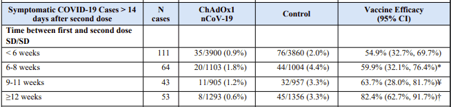

It recommends a second dosing 12 weeks apart. The article in the local paper announcing this said with a 12 week second dose it had 82% efficacy. This was the finding of the Lancet preprint:
https://papers.ssrn.com/sol3/papers.cfm?abstract_id=3777268
Associate Professor in infectious diseases, Dr Michelle Ananda-Rajah, from Monash University, has doubts about the paper (and after reading it the statistician in me does as well):

I do agree with the criticisms that the statistics for the paper are not great (mainly because of small sample sizes). For example, the claim that the second dose had 82% efficacy was based on testing ~1300 individuals in the vaccine and control groups, a factor of ten smaller than the number of individuals tested in the Pfizer-BioNTech and Moderna phase 3 trials.
There are good scientific reasons to believe that a longer delay between doses would make the vaccine more effective, but more data is necessary to confirm. That said, I'm not opposed to the decision to approve the vaccine.
I will note that there are good reasons to be skeptical of "secondary" outcomes from clinical trials. The primary outcome of a trial is the one that the outcome that the trial set out to test (in the case of COVID-19 vaccine trials, this is usually the amount of symptomatic infections). Secondary outcomes are outcomes that were also measured. The problem of trusting results from secondary outcomes is one of multiple hypothesis testing. If you measure enough variables in a study, you're virtually guaranteed to find one outcome that is a statistically significant outlier by chance.
Physicists should be well aware of this phenomenon. For example, in the data collected from the LHC to find the Higgs Boson, researchers found a statistically significant 750 GeV diphoton excess in the data that many took to be a sign of a new particle. However, in subsequent tests to confirm the signal found that the "new particle" did not actually exist and was just a random statistical anomaly in the original dataset. The worry here is that some of the secondary findings of the Oxford-AstraZeneca trials that the researchers have been pointing at to distract from the relatively poor primary outcome of 62% vaccine efficacy are similar statistical anomalies in the trial data.
Exactly - each hypothesis should have its own experimental design. That is my 'statistical' objection. The results they obtain could be valid, but need to be backed up by a properly designed study before stating it in a story about the vaccine that the public will be using to make decisions on what vaccine to get - if they get the choice. They may not here in Aus because we have enough Pfizer to do half the adult population ie the at risk groups and those working with them. If my doctor gives me the choice I will take the Oxford vaccine with the second dose 12 weeks later because I am personally very carefull. But that is just me. I was just watching a discussion on the TV and the valid point was made by the time most people actually get the vaccine more information will be known and not to really worry about it till them. Probably, pragmatically, the best advice.
